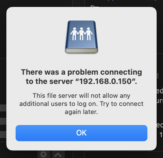

The first is that several times now when I go to view my shared on my Mac I receive the following error:
If I restart my Mac, it still won't let me log in.  However, if I reboot Unraid, it does. I'm the only user. It worked fine before. I'm not sure why I'm receiving this error.
So this morning, it happened again for the second time and I rebooted Unraid. But this time, I received the error

All I did was click "reboot."
I'm looking through the documentation. Nothing seemed to be running abnormally. UPS was fine, no power drop. I tried rebooting so I could connect to the share again because of the "won't allow additional users to login" error from my Mac.
Is there a process that I should follow? Two of the drives were spun down (disk settings: set to spin down after an hour) at the time including the parity drive. Do I need to make sure drives are spun up to do a reboot or does Unraid make sure that when a reboot is done, everything is where it should be?
Do I need to stop the array before doing a reboot or does Unraid do then when rebooting?
