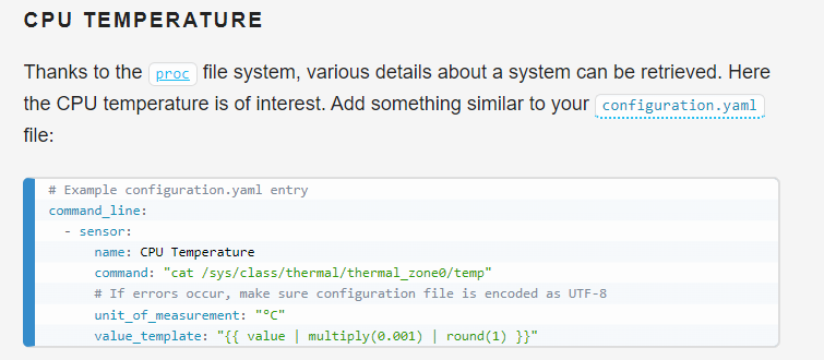

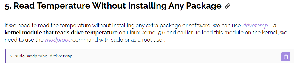

Below is the methods how you know the path
https://www.baeldung.com/linux/hdd-ssd-temperature
And last is convert it to sensors
https://www.home-assistant.io/integrations/command_line/

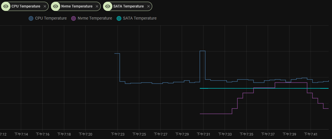

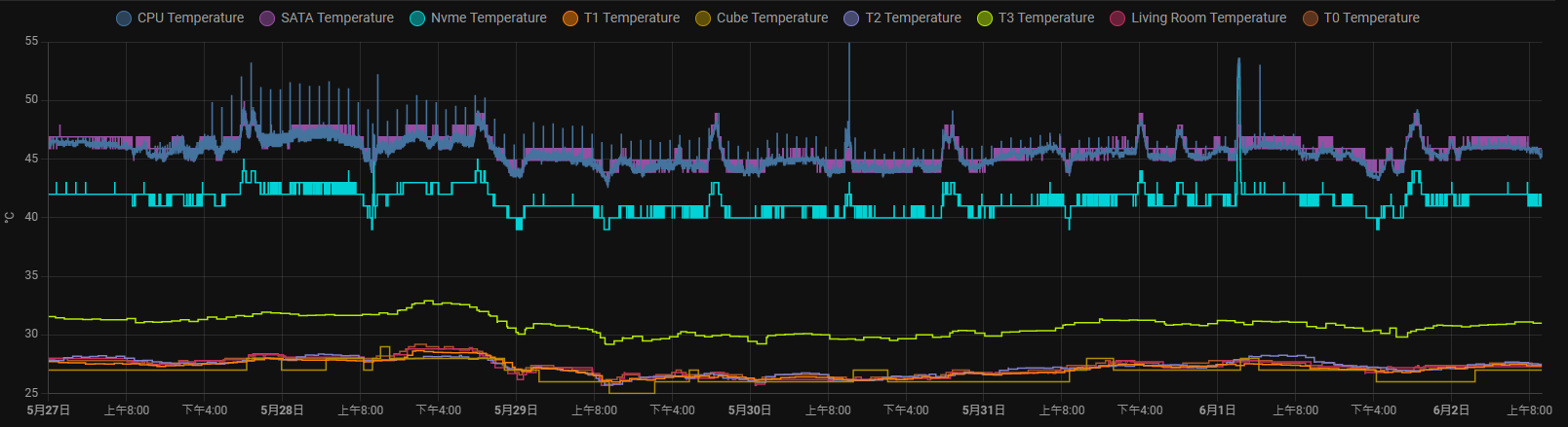

3. restarted HomeAssistant, hoping to see the datapoints. Nothing happened.
Took me also a while to make the Docker able to use smartctl. @Vr2Io, how did you manage to get the data in? Could you give a more detailed input? Would be thankful for any help!

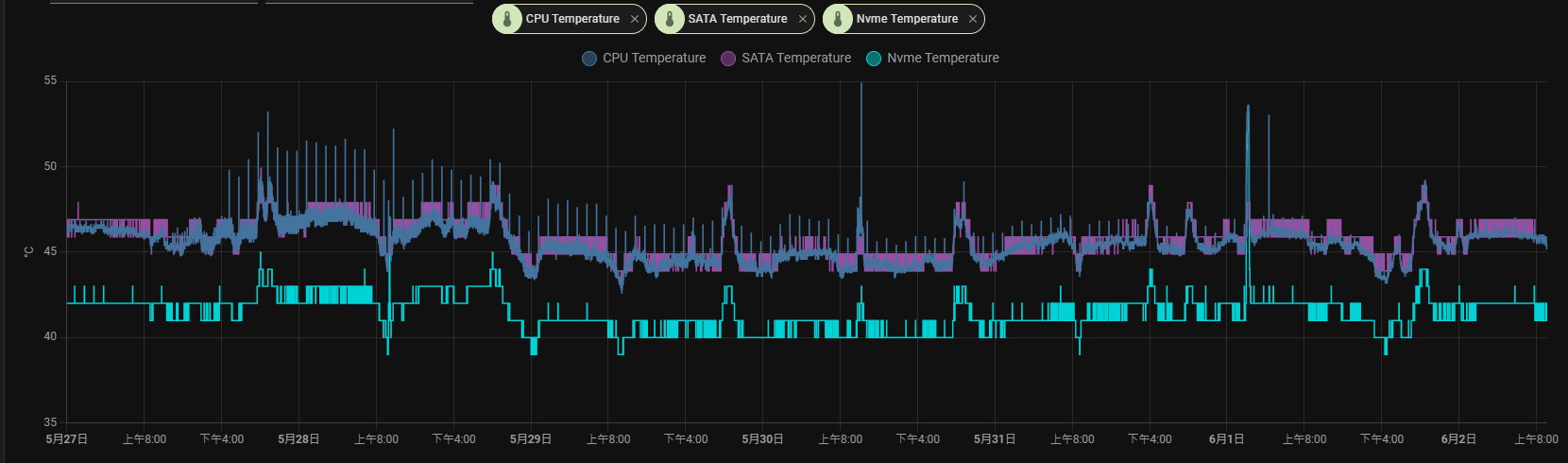

Below are the sensor config which I input to configuration.yaml. That's all.
command_line:
  - sensor:
      name: CPU Temperature
      command: "cat /sys/class/hwmon/hwmon0/temp1_input"
      # If errors occur, make sure configuration file is encoded as UTF-8
      state_class: measurement
      device_class: temperature
      unit_of_measurement: °C
      value_template: "{{ value | multiply(0.001) | round(1) }}"
  - sensor:
      name: SATA Temperature
      command: "cat /sys/class/hwmon/hwmon1/temp1_input"
      unit_of_measurement: "°C"
  - sensor:
      name: Nvme Temperature
      command: "cat /sys/class/hwmon/hwmon3/temp1_input"
It work.

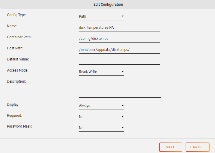

    • Add an additional Path "Add another Path, Port, Variable, Lable or Device"
    • The host path from the Unraid system, which we have created and in which the temperatures are written by the “User Scripts” app, is therefore routed to the container path. In other words, the files in the disktemps folder become available in the container (normally containers do not have access to data outside the container).

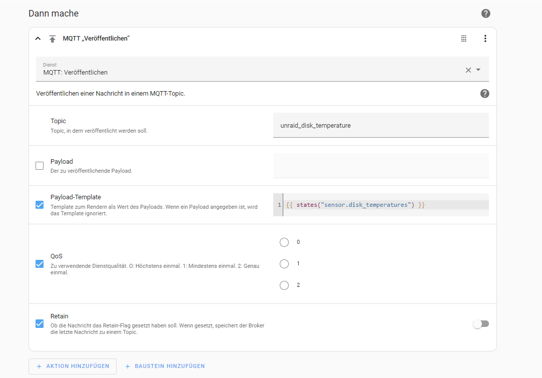

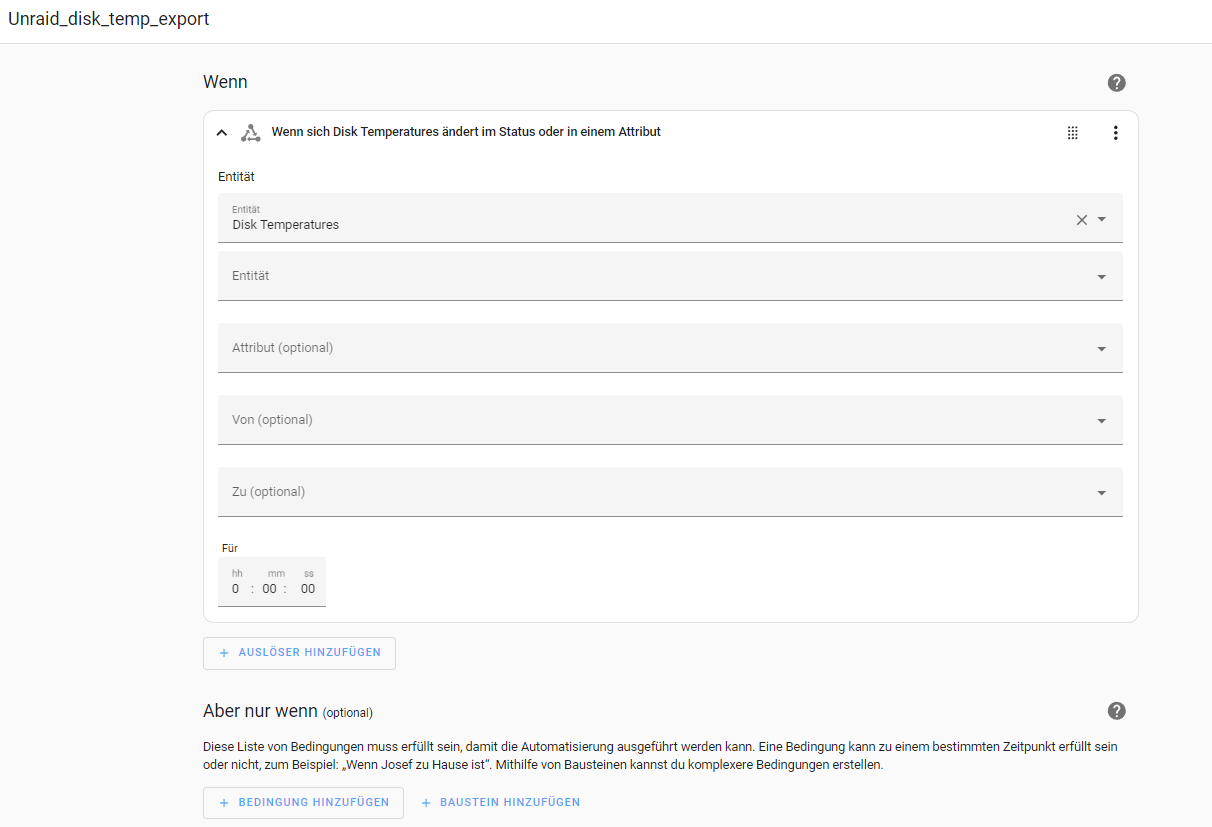

  • set up new automation in HomeAssistant
    • Settings -> Automations & scenes -> Create automation -> Create new automation
      Enter the following (sorry for being in German, you surely can translate easily via a translator ;-) ) :
Safe, close, try. Now, the data should be send to the other system via MQTT.
