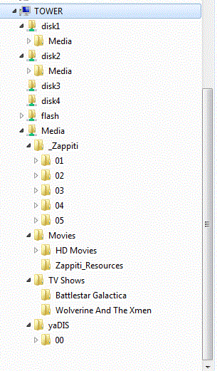

My folder structure

Yes I did check to see if I could write directly to disk2.  Work no problems. Sense I changed my split level to 10 I am able to continue adding files. I am stil a littl estumped as to why it filled disk1 all the ay up. I was under the assumtion that high water would only use half the disc and move and so fourth.
that partly depends on the structure of your data & the split level value.
for example a split level of 1 when all of you data resides under the same 1st & 2nd level directory would result in this behavior (ie all of the data going to the one disk).
if you dont care about co-locating data on the same disk, then set the split level to some arbitrarily high number (that exceeds your greatest directory depth). you should then see the data spread across your disks as you had oriiginally expected.
