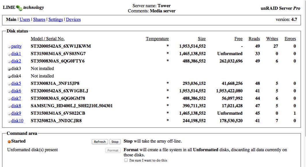

After a power loss I see 2 unformatted disks. Disks 1 and Disk 9. It looks like bad blocks.Anything I can do to not lose data?
Thanks, Will
syslog_122411.txt
Here is a screen shot of my web interface.
Im running 4.7

Disk 9:
root@Tower:~# smartctl -d ata -a /dev/sdb
smartctl 5.39.1 2010-01-28 r3054 [i486-slackware-linux-gnu] (local build)
Copyright © 2002-10 by Bruce Allen, http://smartmontools.sourceforge.net
Smartctl open device: /dev/sdb failed: No such device
Here is what I get for Disk 1:
root@Tower:~# reiserfsck --check /dev/sda
reiserfsck 3.6.21 (2009 www.namesys.com)
** If you are using the latest reiserfsprogs and  it fails **
** please  email bug reports to [email protected], **
** providing  as  much  information  as  possible --  your **
** hardware,  kernel,  patches,  settings,  all reiserfsck **
** messages  (including version),  the reiserfsck logfile, **
** check  the  syslog file  for  any  related information. **
** If you would like advice on using this program, support **
** is available  for $25 at  www.namesys.com/support.html. **
Will read-only check consistency of the filesystem on /dev/sda
Will put log info to 'stdout'
Do you want to run this program?[N/Yes] (note need to type Yes if you do):Yes
reiserfs_open: the reiserfs superblock cannot be found on /dev/sda.
Failed to open the filesystem.
If the partition table has not been changed, and the partition is
valid  and  it really  contains  a reiserfs  partition,  then the
superblock  is corrupted and you need to run this utility with
--rebuild-sb.
The file system is NOT on /dev/sda.
It is on the first partition on any give disk.  For sda, the first partition is /dev/sda1.  The reason reiserfsck cannot find a superblock on /dev/sda is because is it not there.  IT is on /dev/sda1.
You'll need to run reiserfsck on /dev/sda1
or
better yet
if the device is assigned and the array starts, it is accessible as /dev/mdX  (where mdX = md1 for disk1, /dev/md2 for disk2, etc...)
Running reiserfsck on the /dev/mdX device allows the correction to also fix parity.  Making a fix on the /dev/sdX1 partition will require you to run a correcting parity calc to correct parity and get it in sync with any fixes you make.
Joe L, Thanks for the reply. This is my results
root@Tower:~# reiserfsck --check /dev/sda1
Will read-only check consistency of the filesystem on /dev/sda1
reiserfsck --check started at Mon Dec 26 12:23:39 2011
Replaying journal: Done.
Reiserfs journal '/dev/sda1' in blocks [18..8211]: 0 transactions replayed
Checking internal tree.. finished
Comparing bitmaps..finished
Checking Semantic tree:
finished
No corruptions found
There are on the filesystem:
Leaves 108876
Internal nodes 683
Directories 9673
Other files 67833
Data block pointers 104292752 (0 of them are zero)
Safe links 0
reiserfsck finished at Mon Dec 26 12:47:02 2011
Any ideas? I have 2 new 2TB drives, but I don't want to lose this data
Thanks!

Mick thanks for the suggestion but both disks crash the app when trying to scan these drives.
Tom gave me some commands to manually mount Disk1 and pull the data off of it. So that was great. The problem is unRaid still thinks disk1 isnt formatted and disk9 is totally hosed. So I cant do a parity restore since it still shows 2 disks as bad. So at this point I may have to just lose the 1.5TB of data off of drive9 unless omeone has any good ideas.
Thanks, Will
