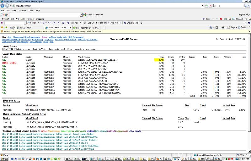

Rebooted and now 3 drives show as unformatted.
disk1 (sdm) also disabled/redball
disk2 (sdn)
disk3 (sdk)
smartctl reports attached

index.php?action=dlattach;topic=17523.0;attach=9386;image
