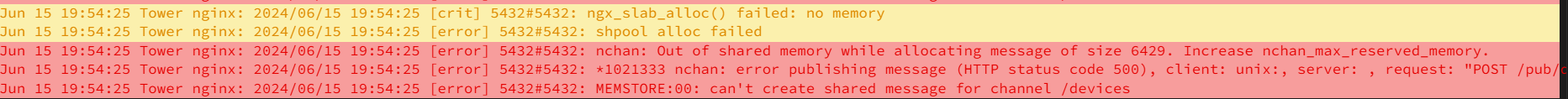

I noticed the in dashboard system memory, ZFS is always 100%
here is system log that is showing these errors.
I had drives with health problems and when I looked the drive error it was old age,
but now I removed all drives and kept the necessary ones and until I but new drive to expand the capacity.
thanks
tower-syslog-20240616-0905.zip
