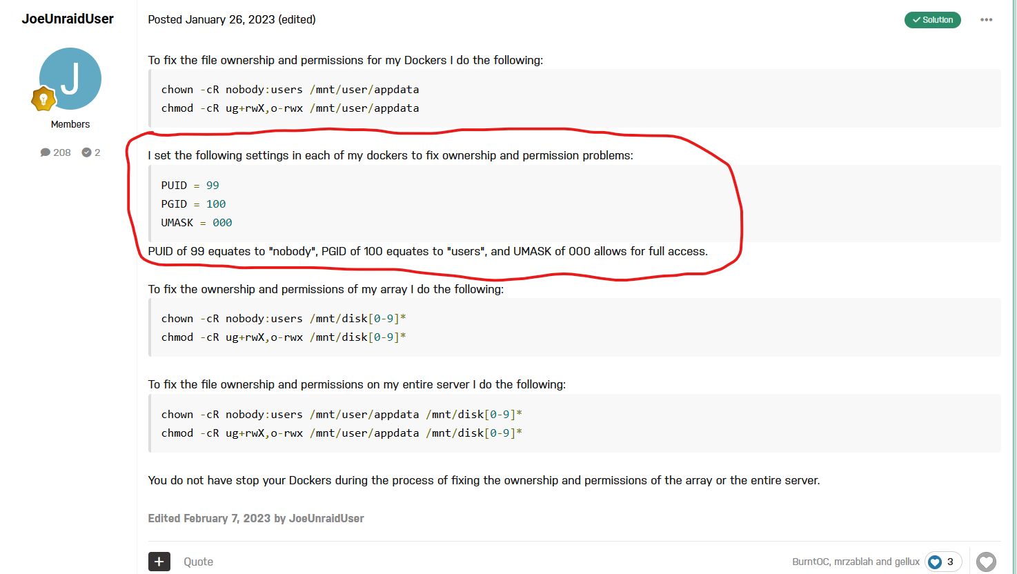

well after a couple of hours googling it seems that it was my docker permissions ran docker safe new perm and i can now read/write to the files in this share. @Frank1940i will have a read up on what you suggested.
Thanks
Glad you found the problem.   Docker safe permissions will temporarily fix the current problem  but it will not prevent the problem from reoccurring!   See this and make sure that you have fixed it permanently.
