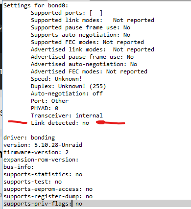

I would suggest that you check Ethernet cables and connections.  You do not have a link to switch/router detected.  I saw in the syslog that it selected an IBM 2.5G driver.
But I also did not see any evidence that eth0 was detected and set up.  I would have expected to find entries in the syslog with details about it when it was detected.
