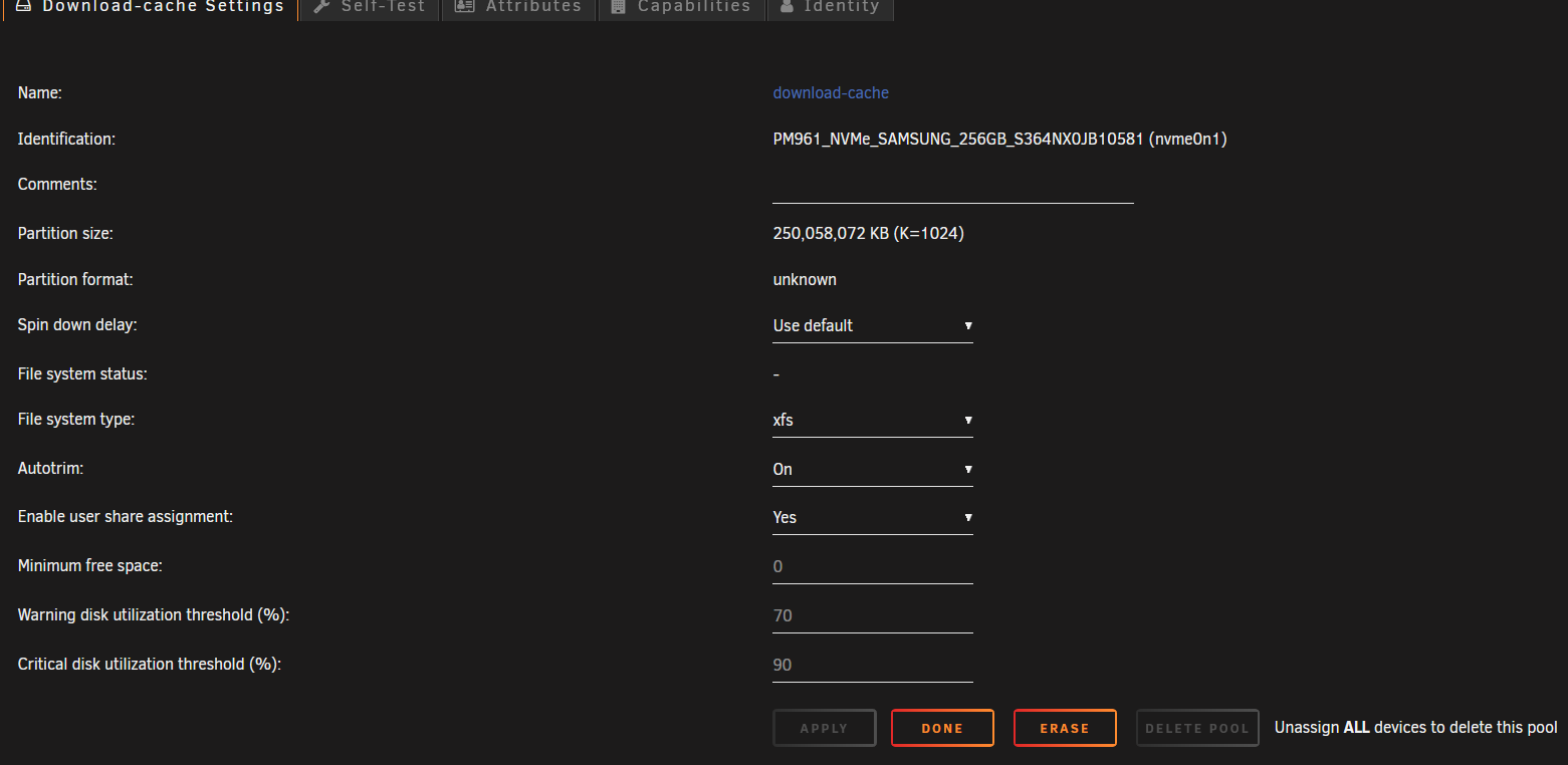

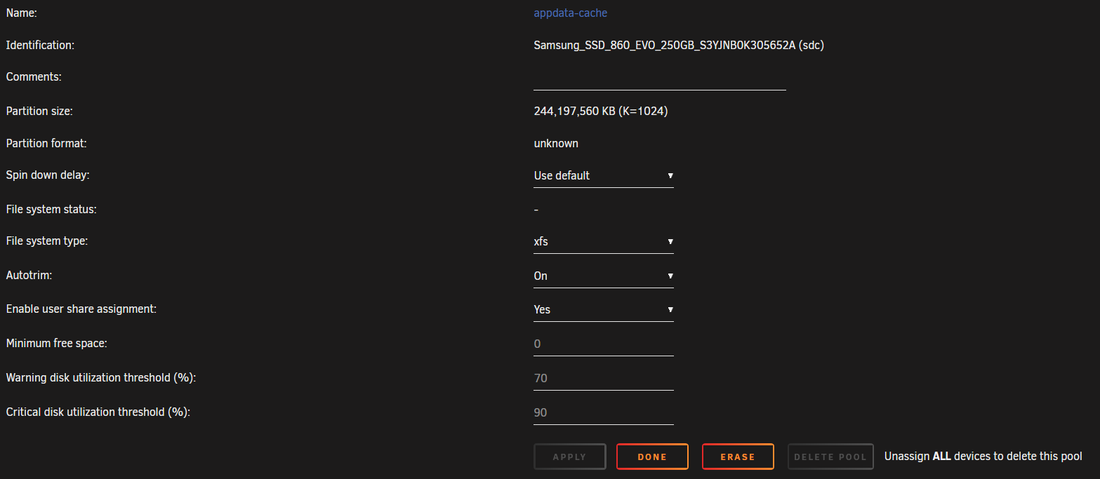

However, the drives don't appear to have partitions

As you can see from the screenshots both discs don't have any partition format info
