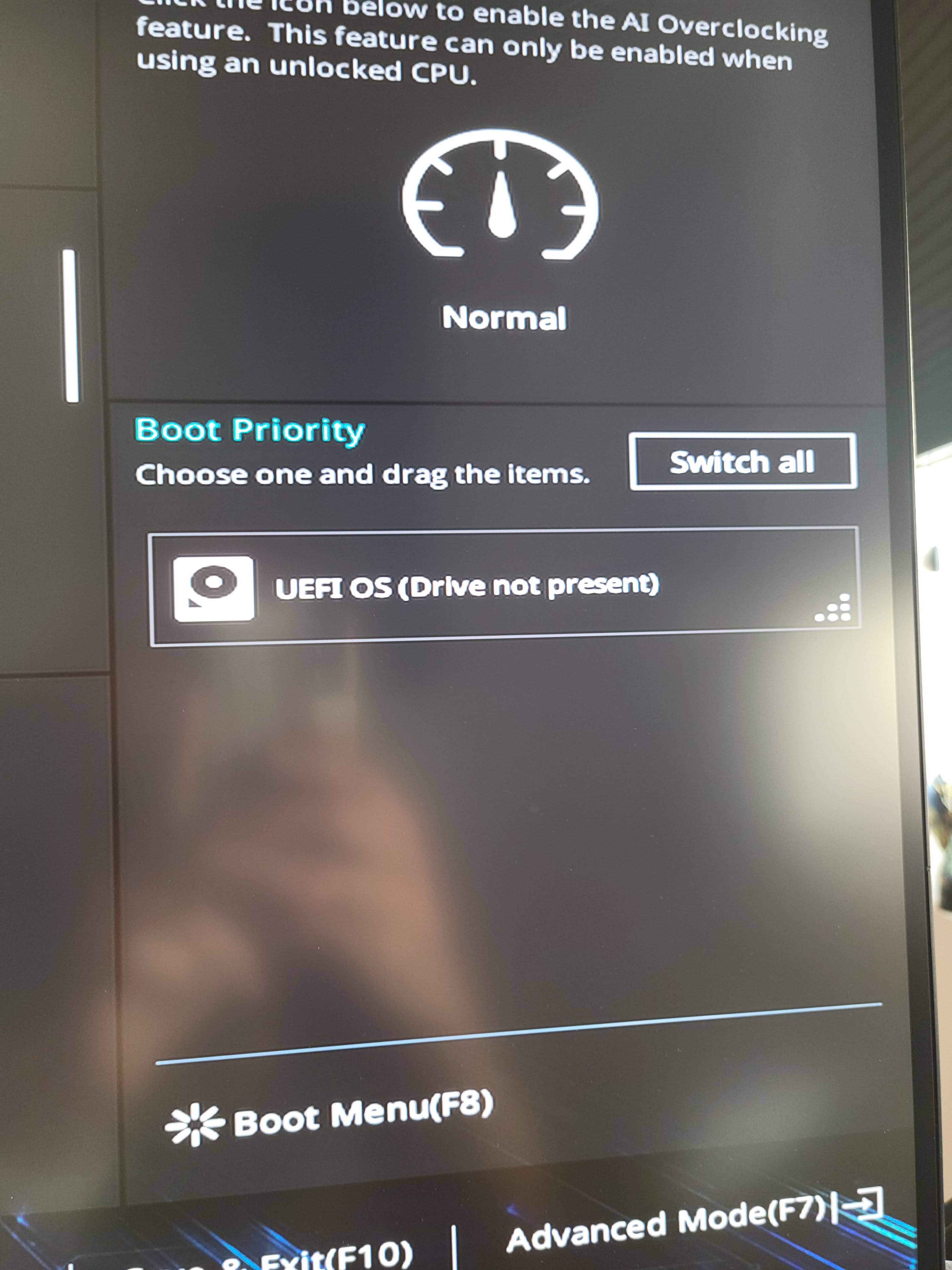

tried new fresh drive no luck. Just like the other drive it never appears in boot menu (that happened even when the system worked). I disconnected drive 5 to see if that would help. but nothing. I tried turning off fast boot no change.

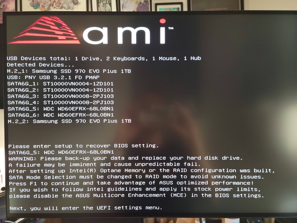

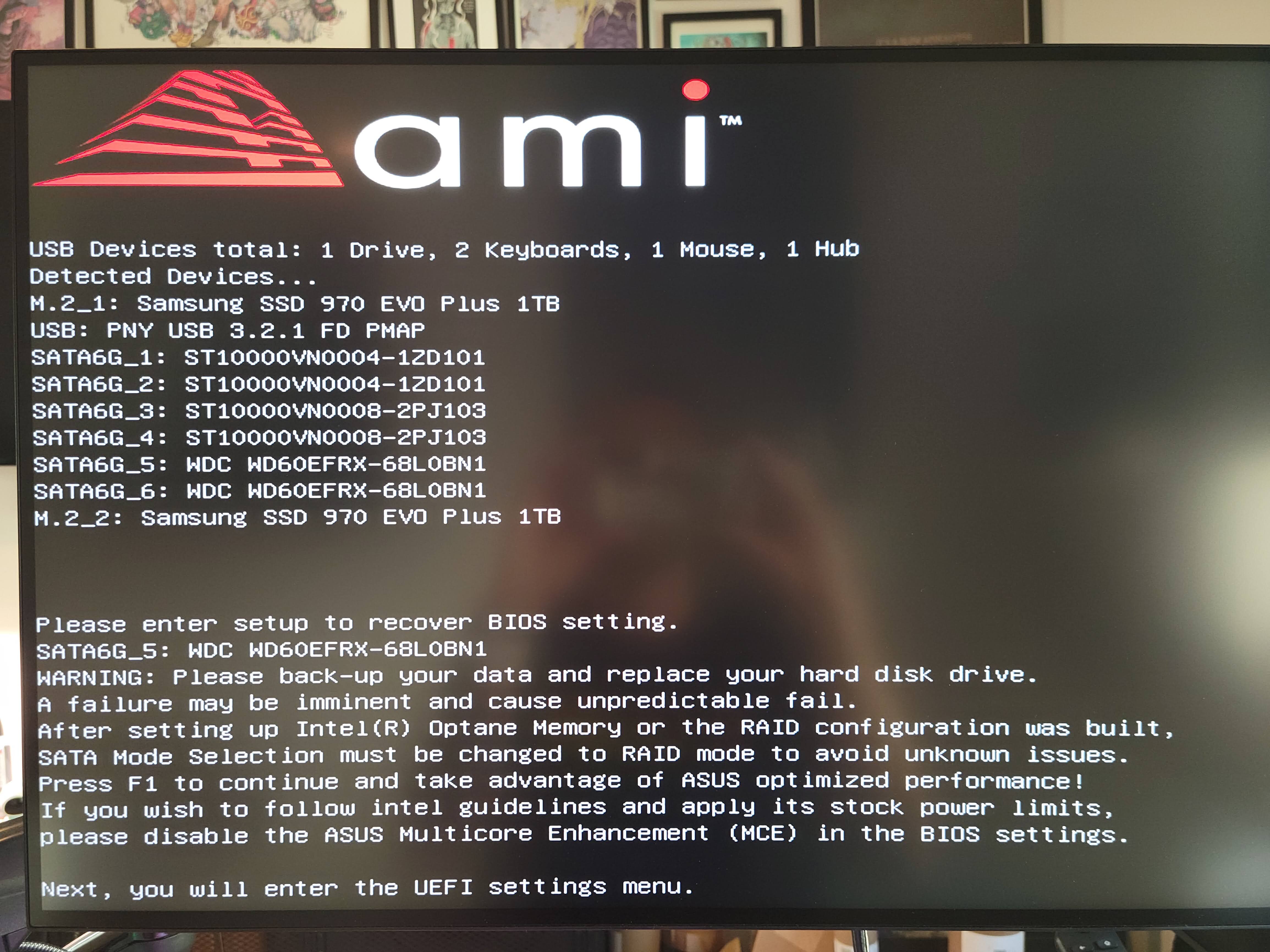

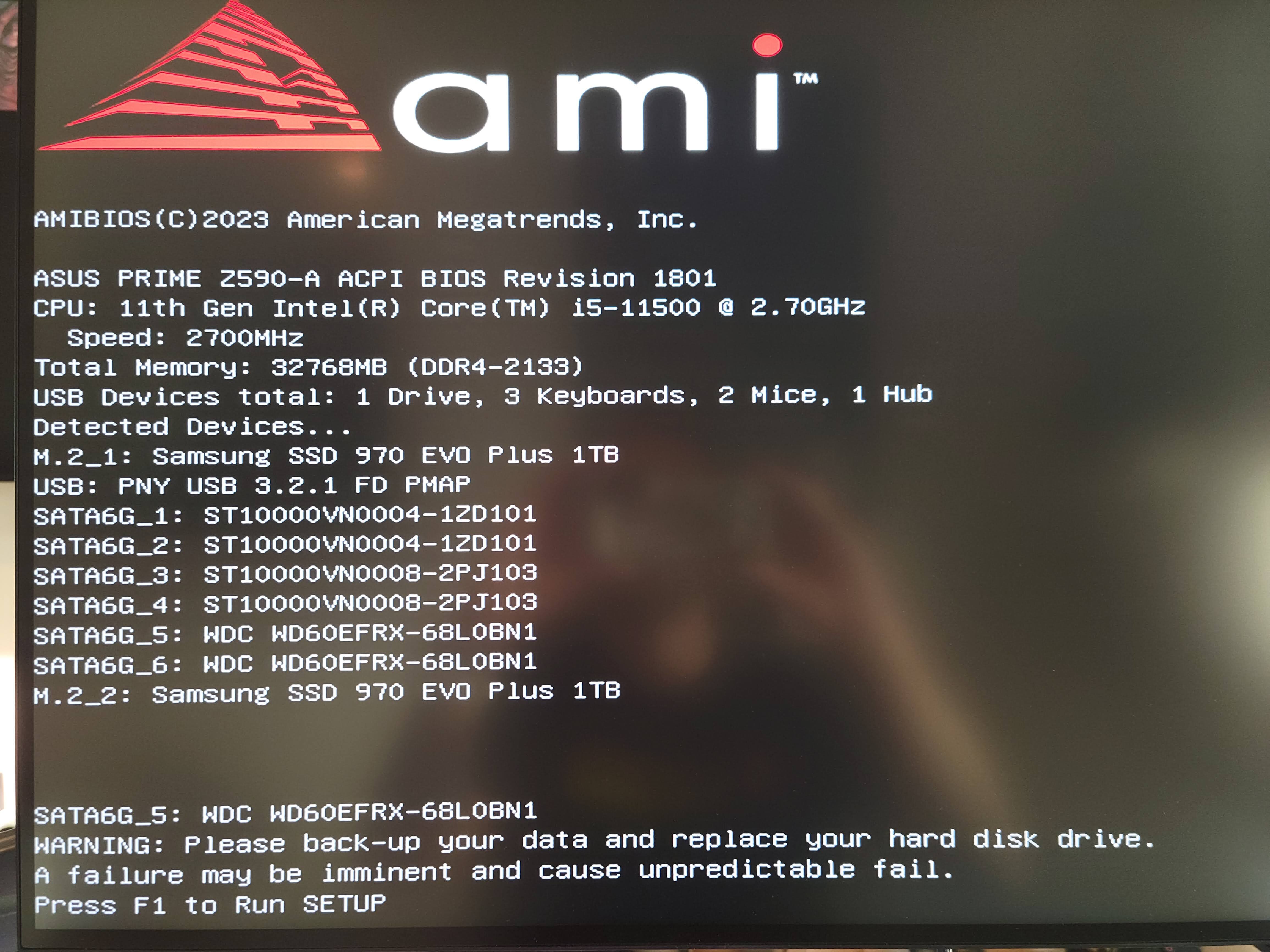

Looks like the flash drive is not being detected, press F8 during post and post a photo of the boot menu.
OK making progress 3rd flash drive worked. But also seems I need to disconnect the drive in slot 5 as if it is connected things wont boot.

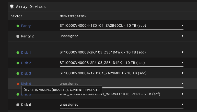

So my new question is this "Device is missing (DISABLED), contents emulated" enough to satisfy that warning message above? I started the array with it missing and then stopped it again so now it mentions 'DISABLED' but want to confirm that is good enough to continue on.
Yes.
