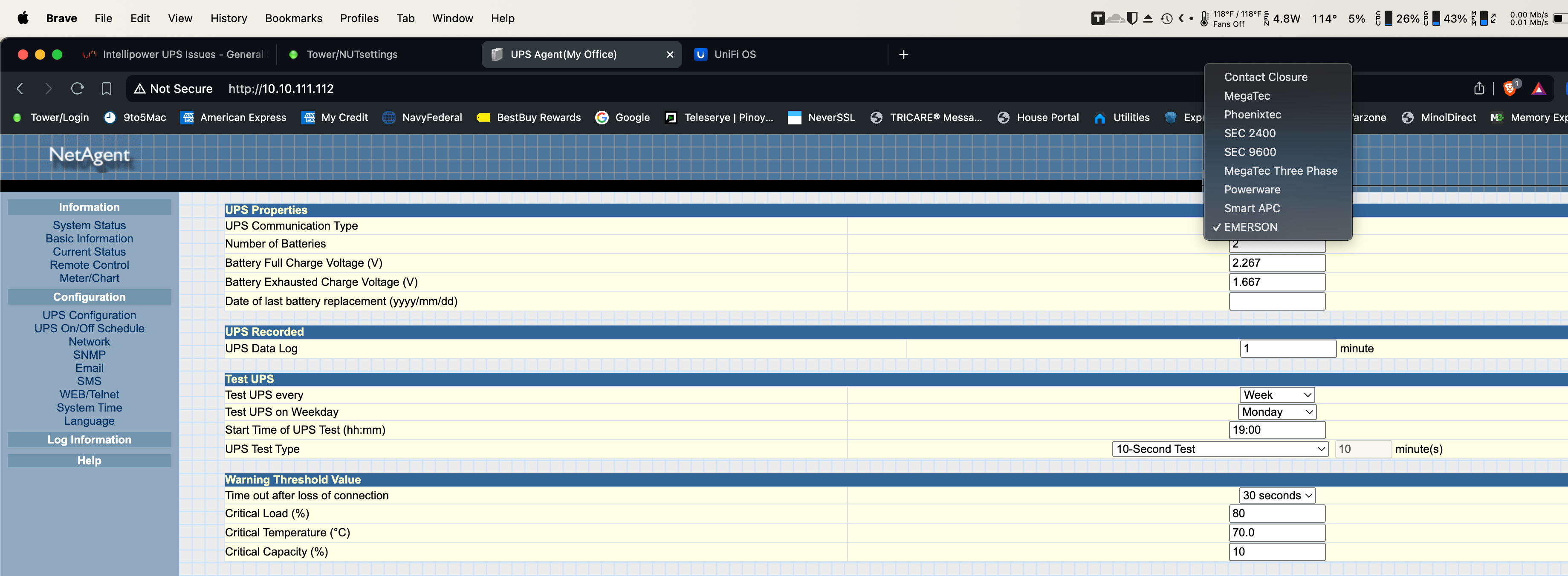

June 30, 20242 yr Currently I have an APC UPS (non-rackable) to provide backup power in case of a power outage. I've been looking for a rackable UPS and I was recently able to secure a get a Intellipower IHT1500RM-DI-Isol-FC-399 rackable UPS. The issue is I am unable to get the built in UPS monitor to communicate with it. When I plug in the ethernet to usb cable to the port, the activity light on the UPS does not light up. If I plug the it into to my network with a patch cable, it populates in my network devices list but with a 192.168.... IP. My DHCP gives out 10.10..... IP's. The port on the UPS has a label that says NetAgent Mini. I tried NUT plug in but it seams that it is unsupported. Am I out of luck or is that any other suggestions you guys can give me?

July 4, 20242 yr Author I managed to setup a separate network in order to connect to the UPS management port. I set it to use DHCP so now the UPS is connected to my network with it's own IP. I see I can set the communication type but I don't see any option to connect to the UPS via an IP address. I'm beginning to think the usb to Ethernet adapter is not going to work. On 6/30/2024 at 4:23 PM, Vr2Io said: Don't do that !! Only if you confirm the cable / adapter are the right one. It seem that UPS use SNMP, pls connect the UPS Ethernet to your network and well config it, then also try config NUT/APCUPSD with SNMP setting. Edited July 4, 20242 yr by peace-keeping-villa8590

July 5, 20242 yr Author So I was able to connect to it but.... not anymore. I figured out that device needs to be the IP but then all it populated was "0" and calculating for a while. I tried different settings but now I don't remember what I used to get working.
