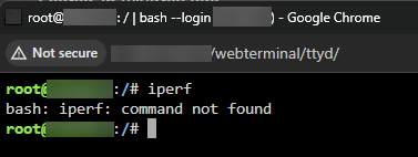

Start by running a single thread iperf test in both directions to confirm the LAN is OK.
I'm trying to find it but I can't. The only place I could find this tool was in a docker container. Should I install it or it should be installed within UnRAID O.S. ?
How do I install it?
Unraid already includes iperf.
root@Tower1:~# iperf3 -v
iperf 3.11 (cJSON 1.7.13)
Linux Tower1 6.8.12-Unraid #3 SMP PREEMPT_DYNAMIC Tue Jun 18 07:52:57 PDT 2024 x86_64
Optional features available: CPU affinity setting, IPv6 flow label, TCP congestion algorithm setting, sendfile / zerocopy, socket pacing, authentication, bind to device, support IPv4 don't fragment
Where??
I'm trying to run it from the terminal inside UnRAID:
I'm using UnRAID 6.12.10
Edited by PetabyteLDA
I apologize for my stupidity...

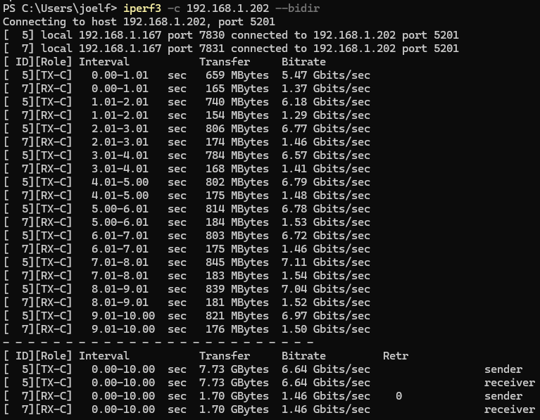

The problem is the transfer speed from and to UnRAID cache.
After testing with iperf3, the transfer speed from Desktop to UnRAID is 6.75 Gbits/s:
And the transfer speed from UnRAID to Desktop is lower at 3.16 Gbit/s!!
And If I test using the "--bidir" parameter the result is even worst.
Can you help me solving this transfer speed issue?
Thank you in advance!
Regards,
Iperf only tests the network, so this is usually a NIC, cable, switch, or client PC problem.
I've already changed the cable and the test is exactly the same.
What else can I do to find what causing this issue?
Are there any setting I need to change in UnRAID to optimize the transfer?

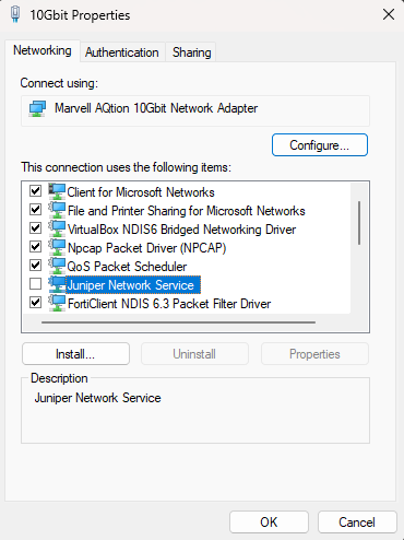

I've solved this issue.
The problem was within Windows 11 configuration of the NIC.
If you use VPNs, make sure you don't have the "Juniper Network Service" active.
Disabling it, make the network connection speed normal again.
Now I can get 9.25Gbit in both directions.
