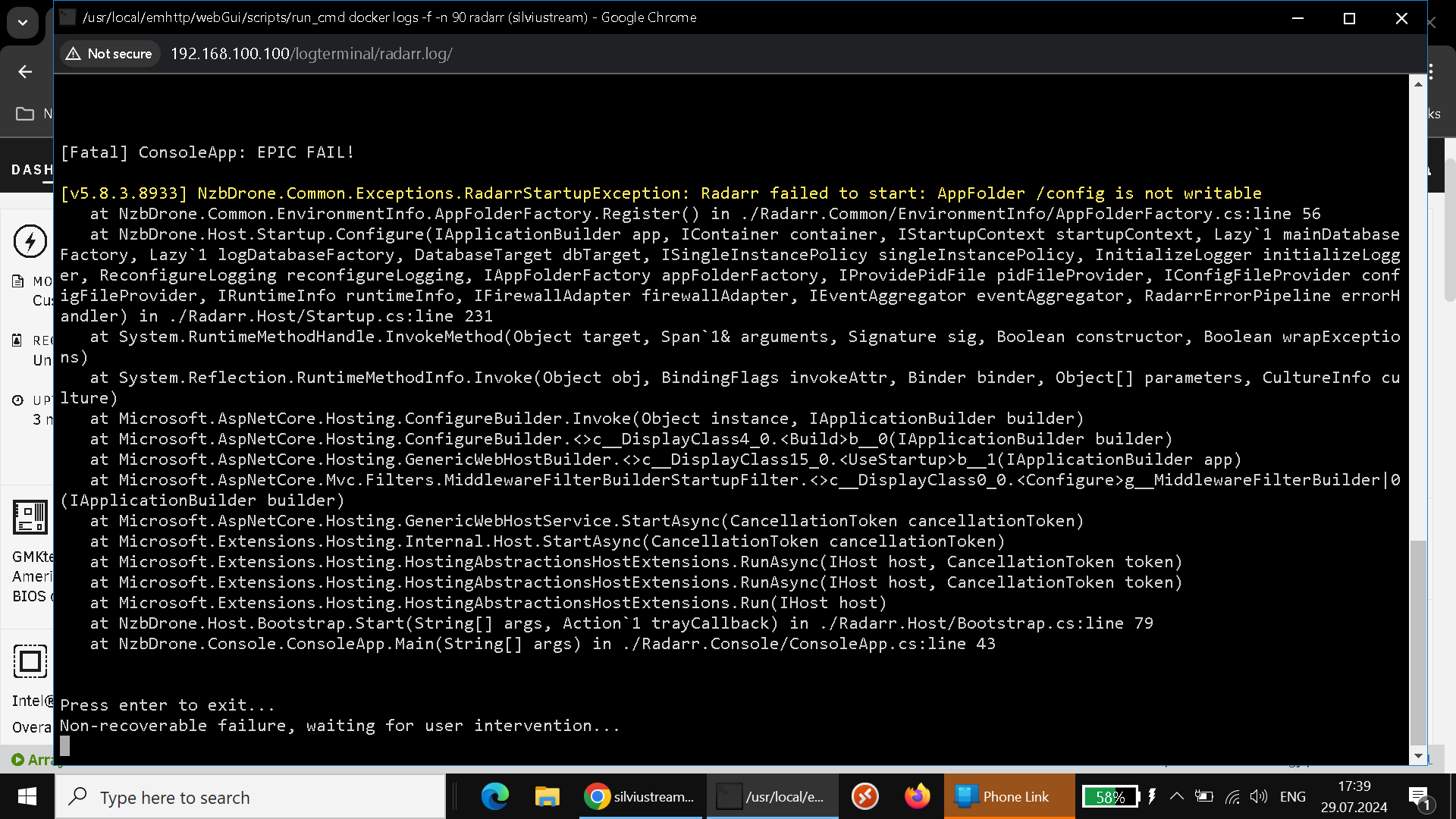

July 29, 20242 yr Author The server was accessible all the time but now i have other problem, all my docker apps ( radarr, qbit, bazarr, sonarr etc) are not accessible, in radarr's log it says that /config is not writable, i was in vacation, i didn't touch any settings, what does that mean? Also i have plex docker and its the only app that is accessible. silviustream-diagnostics-20240729-1745.zip
July 29, 20242 yr Community Expert There are macvlan call traces, updating to 6.12.11 it should fix that, then post new diags after array start if the containers still don't work.
July 29, 20242 yr Author Same error, and i cant delete/recreate docker image. In the same time i have 3 appdata backup folders that occupies half of may cache storage and i cant delete them. i changed the permissions but still nothing. Sometime the folders seams to be deleted but it reappears. silviustream-diagnostics-20240729-2155.zip
July 29, 20242 yr Community Expert Pool has critical filesystem issues: Jul 29 21:54:59 silviustream kernel: BTRFS critical (device nvme0n1p1): unable to find chunk map for logical 9313061045303771136 length 4096 Recommend backing it up and then reformatting.
