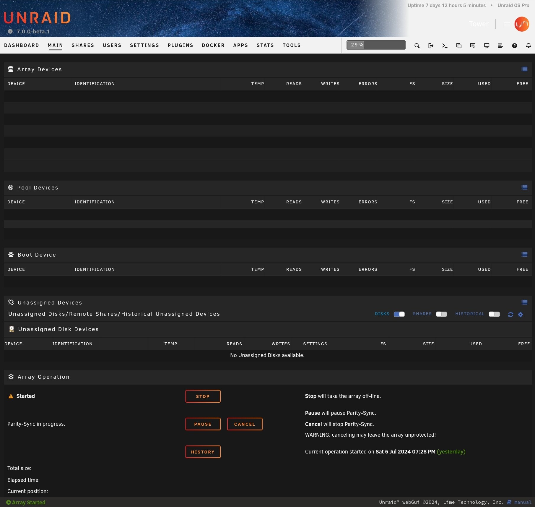

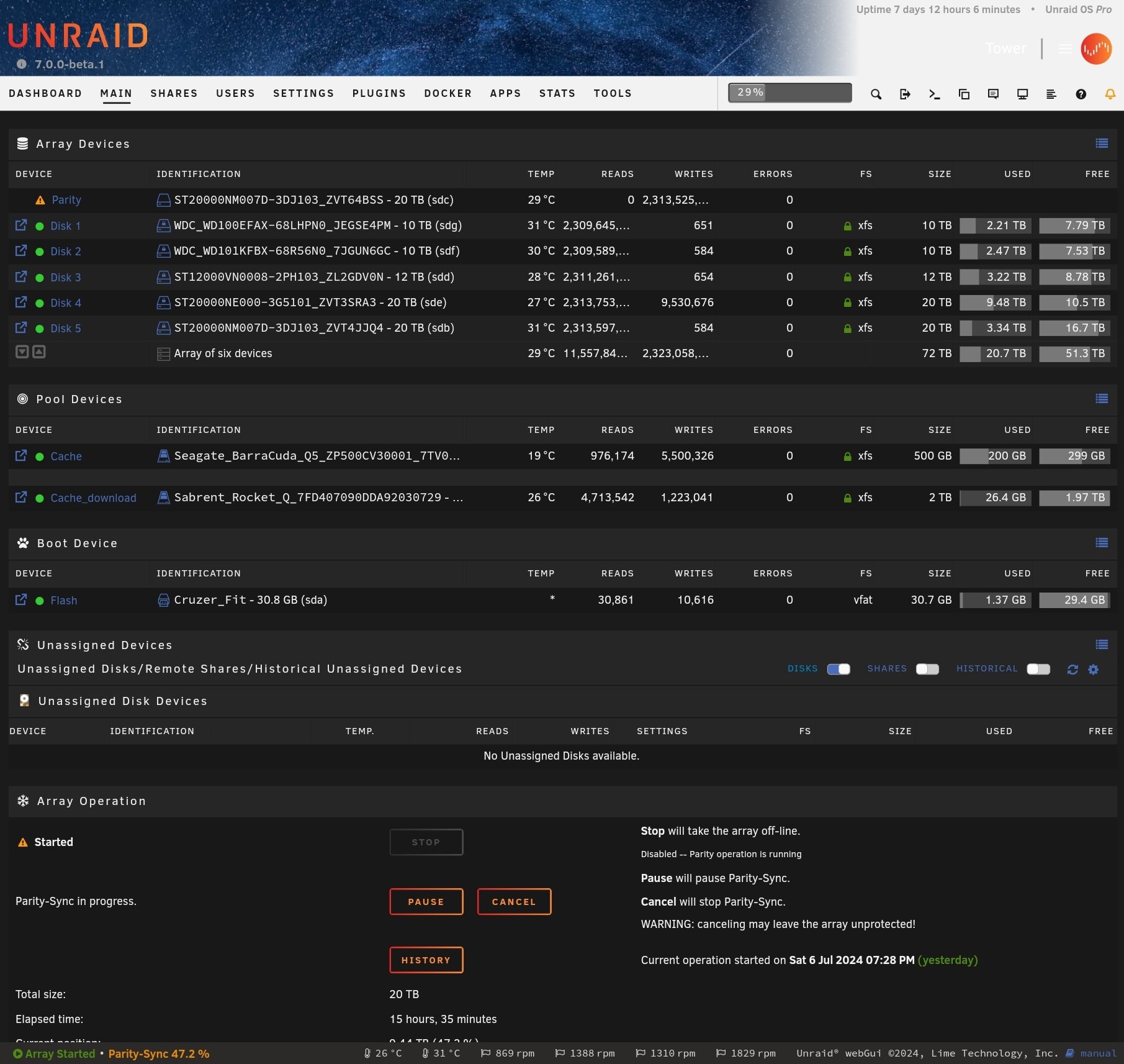

When I remotely connect to my unRaid server via Wireguard (the one built in, not docker), my devices do not show up on the Main tab, nor any of my plugin information along the bottom such as temperature and fan speed.

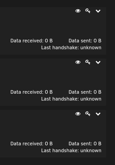

Furthermore, upon looking in the Wireguard service (whilst connected to unRaid on LAN), the handshake information displays as "unknown", whereas on the Dashboard tab it correctly displays the last time I connected.
This is a known issue, for the display issue, are you using the same browser for both? Also make sure no ad-blocker or firewall is blocking the page.
Many thanks for your quick response.
I was using Brave browser (Android) on both occasions. I have just installed Chrome and that works without issue.
As you said, it must have been ad-blocking. Many thanks. 👍
