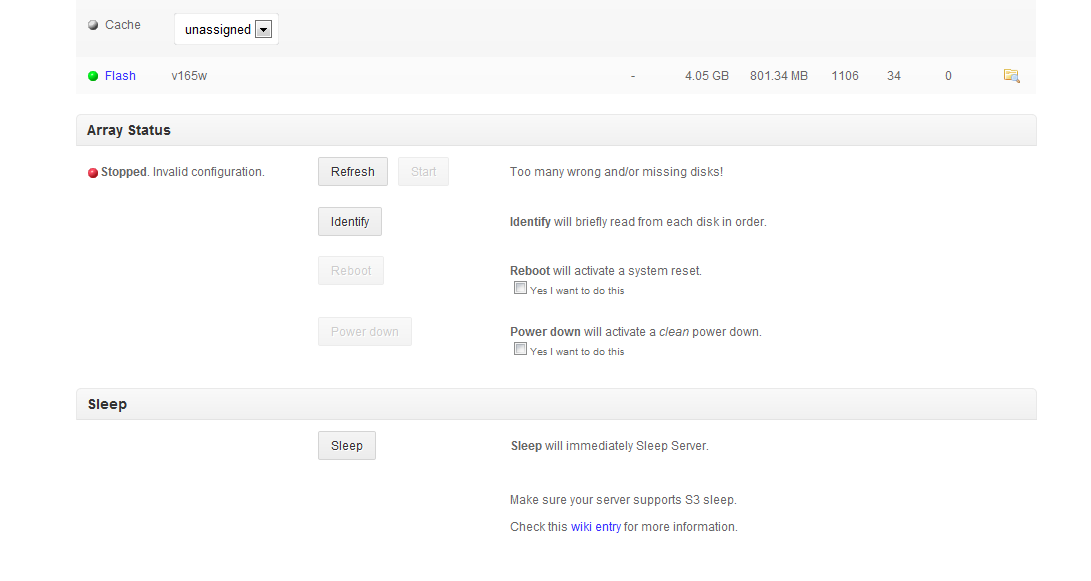

unRAID cannot recover from two failed disks.  If one failed disk caused the other on the same disk controller to appear as failed, then you must power down, disconnect the failed drive, power up, and then test to see if the second drive appears to work.  (run a smartctl report)
If the disk appears to work, about all you can do is stop the array, assign the working drives as you like, then set a new disk configuration.  That will immediately invalidate any prior parity calculations.  When you next start the array, parity will be calculated onto the new parity drive.

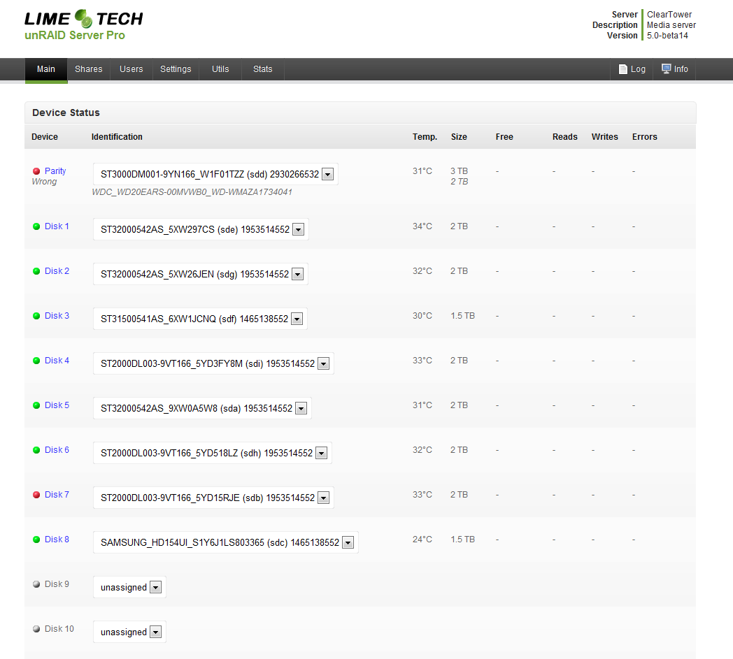

What version of unRAID are you running?    (You might want to post a copy of your syslog  and a screen-shot showing your disabled drive.  Just in case I am not understanding your situation)
Joe L.
The Parity drive I pulled out fails SMART.  I ended up pulling it out and running WD tools on it and it tells me the drive is beyond repair.  It has too many bad sectors.
I am running 5.0 b14.  All I am really looking to do is start the array and have it rebuild parity.  I haven't been trying to recover the second drive in red.  Up till this point nothing has been wrong with that drive.
I am attaching a screen of my main page.

Here is the bottom portion of my main screen.
