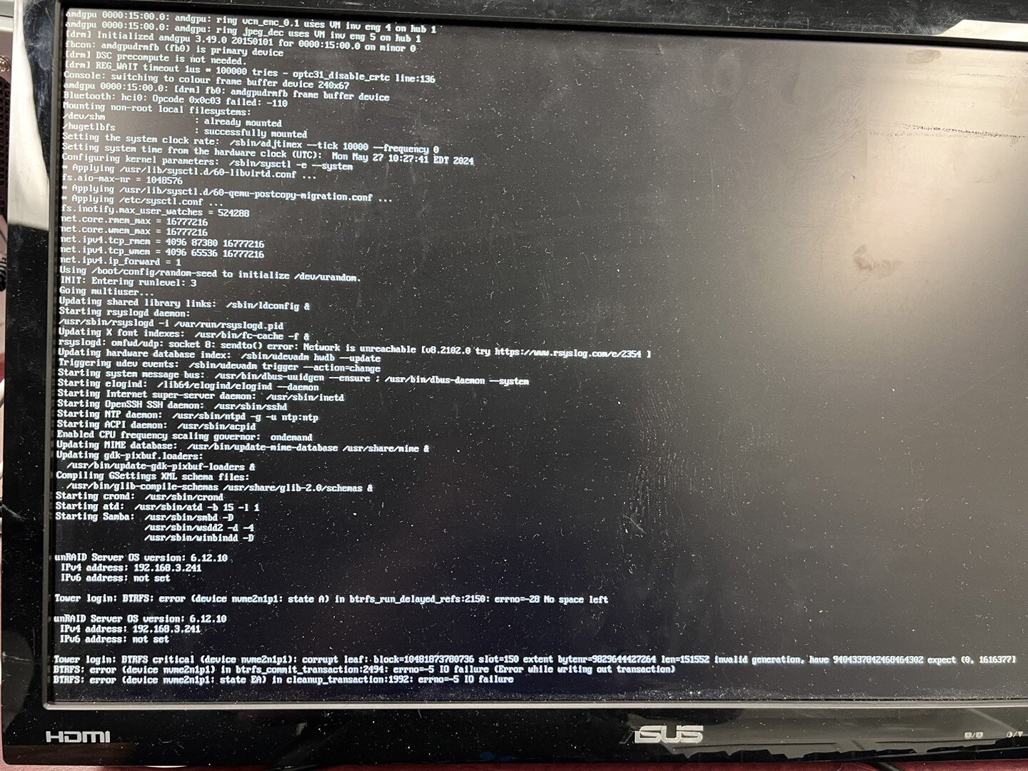

[edit: also found a picture of the prior BTRFS error we were getting. This one would about half the time hang the entire Unraid server requiring a hard reboot.]
