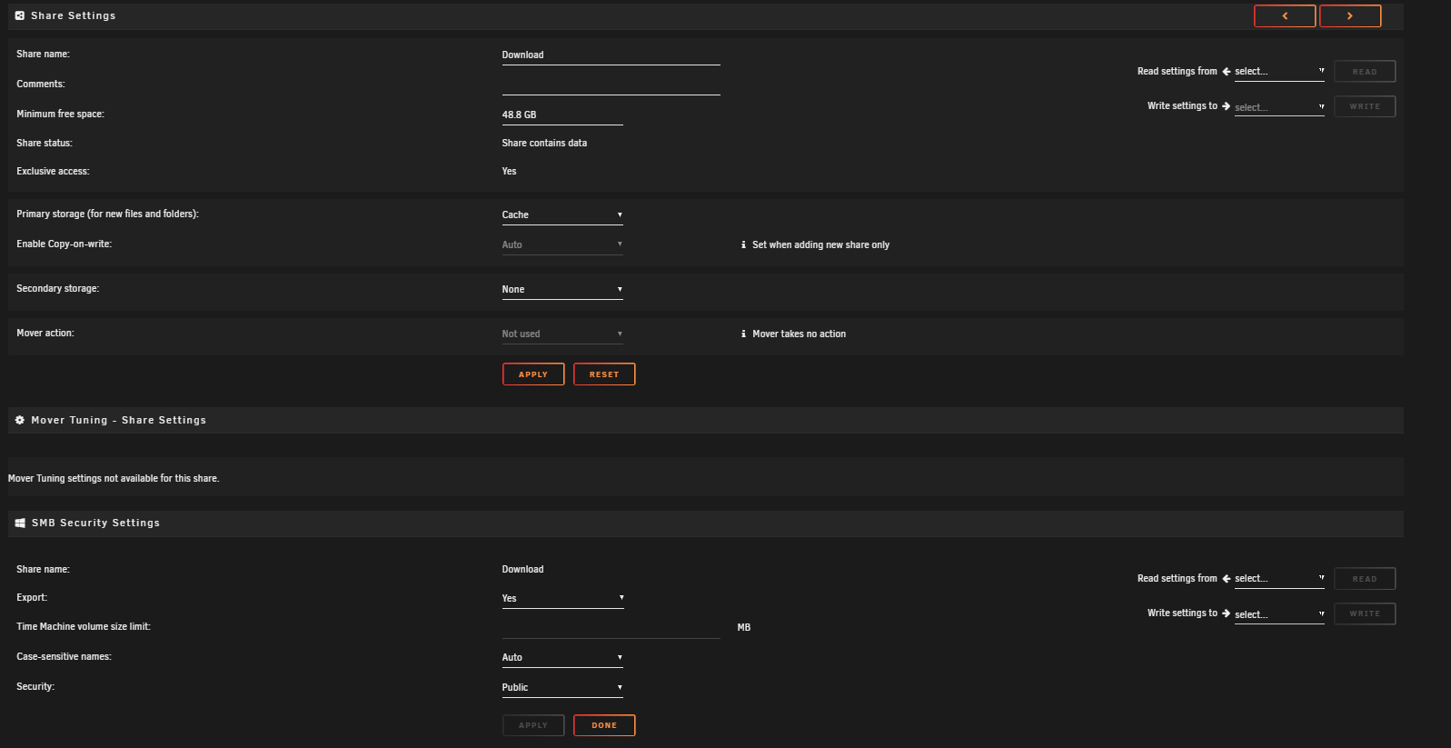

Here is shares list and detail of share downloads

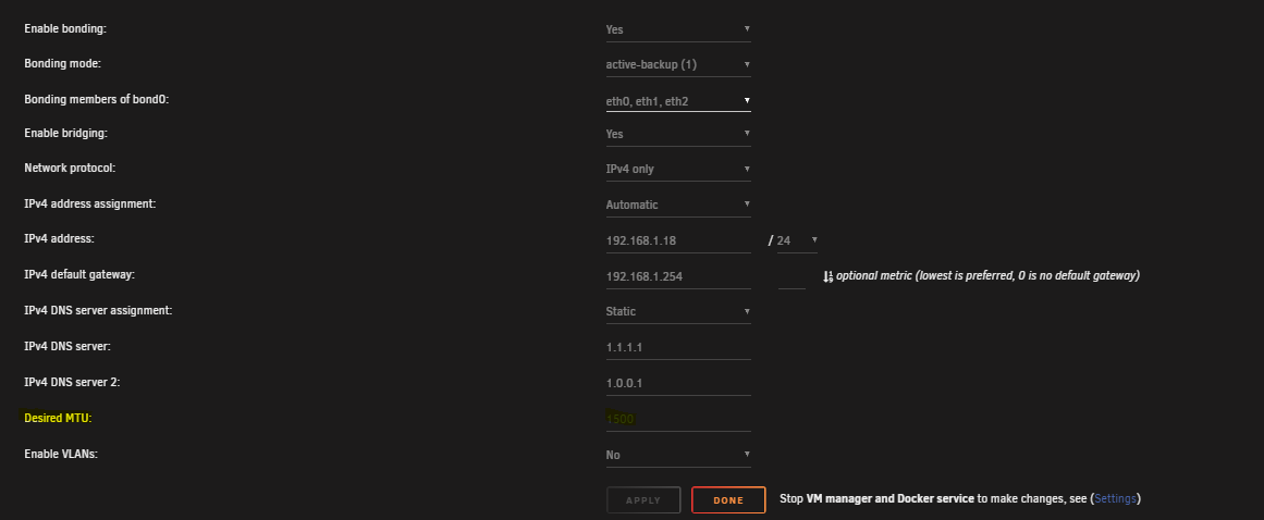

What is your MTU setting?  (It should be 1500!)   Jumbo frames often causes problems...

My MTU setting is at 1500.
