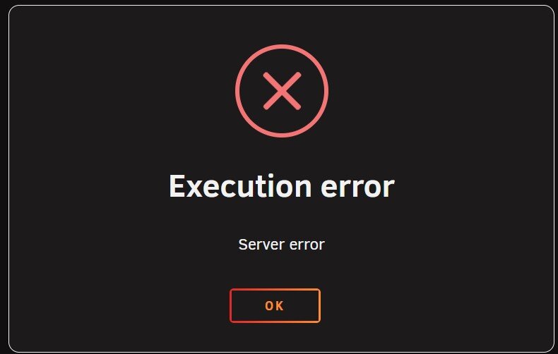

Thanks @JorgeB! I tried changing to docker image, worked for maybe one day and now giving me an Execution Error - Server Error.
cache_docker pool is not mounting, is that expected?
That is the first time I've seen that error. I will try again.
Docker is back. Replacing the cache disk seem to have solved the issue. Thanks!
