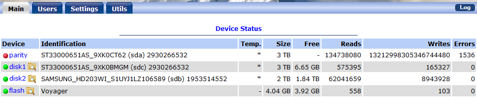

Setup is a HP microserver running unRAID 5.0 beta13
Short story is that I've been using this perfectly fine for months, no errors reported. I check my Main page today and find the attached failure.png image showing the parity disk with a blinking red light and number of errors. A quick scan through the syslog revealed problems trying to spin up the disk and a number of read/write errors (I have attached this in a zip file as it was too large)

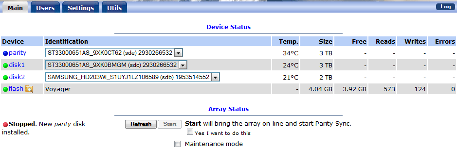

So I tried to run a SMART test on the drive but it would not detect it. I opened the case and checked the SATA and power cables to make sure it wasn't loosened somehow and stopped the array. After it attempted to spin the drive up again, the drive is now detected as blue - a new parity disk (see after.png) - and I can run SMART (report output attached), but I really have no idea what to do next and am scared to restart the array and have it rebuild the parity if the drive is failing.
Can anyone offer some advice on next steps and what they think is going on from the attached syslog and SMART reports?

The SMART report looks fine. Rebuild parity and then run a parity check. Then post a new SMART report
Thanks again for your help. I restarted the array and let it rebuild the parity data (it only took all day ;D) and it seems to be running without error or incident.
