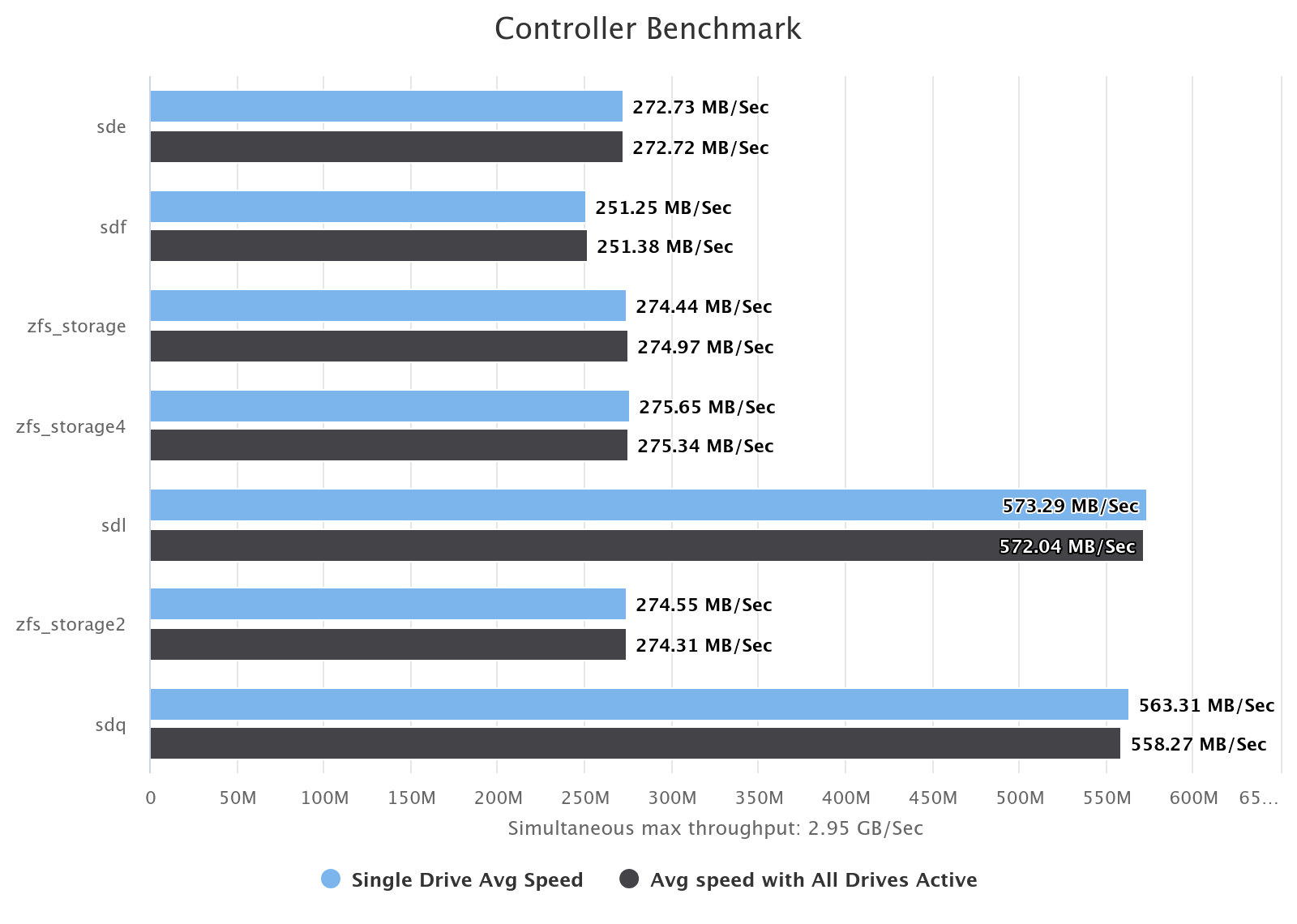

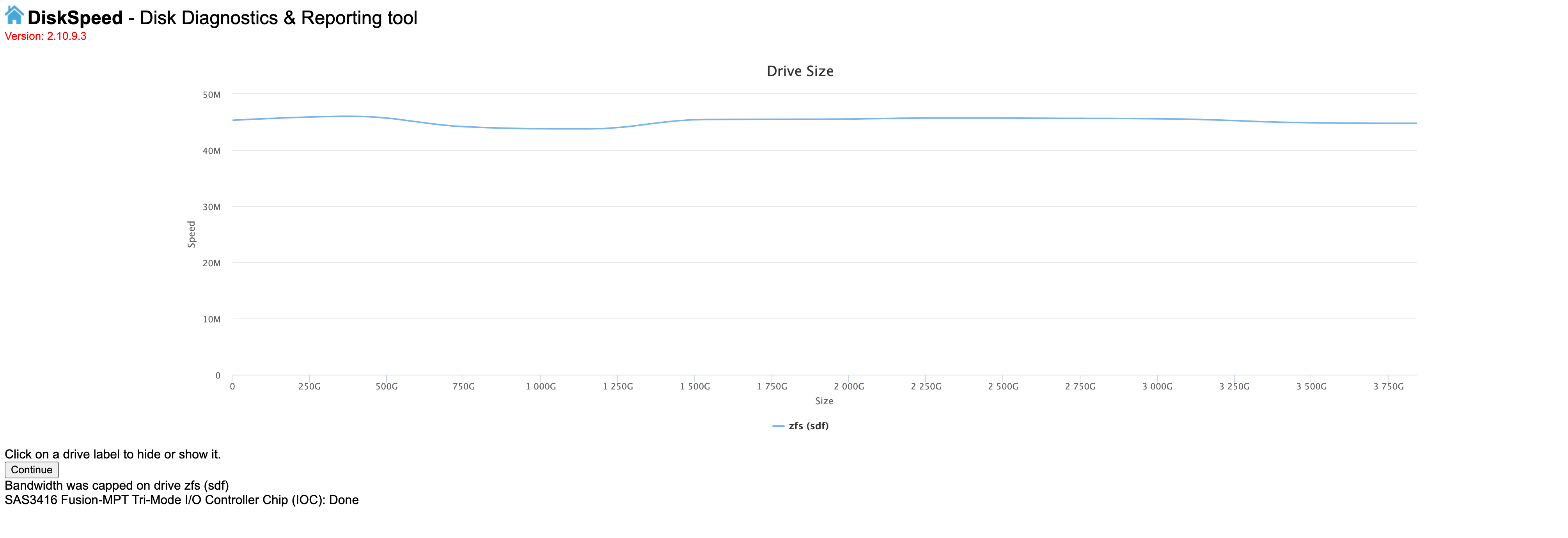

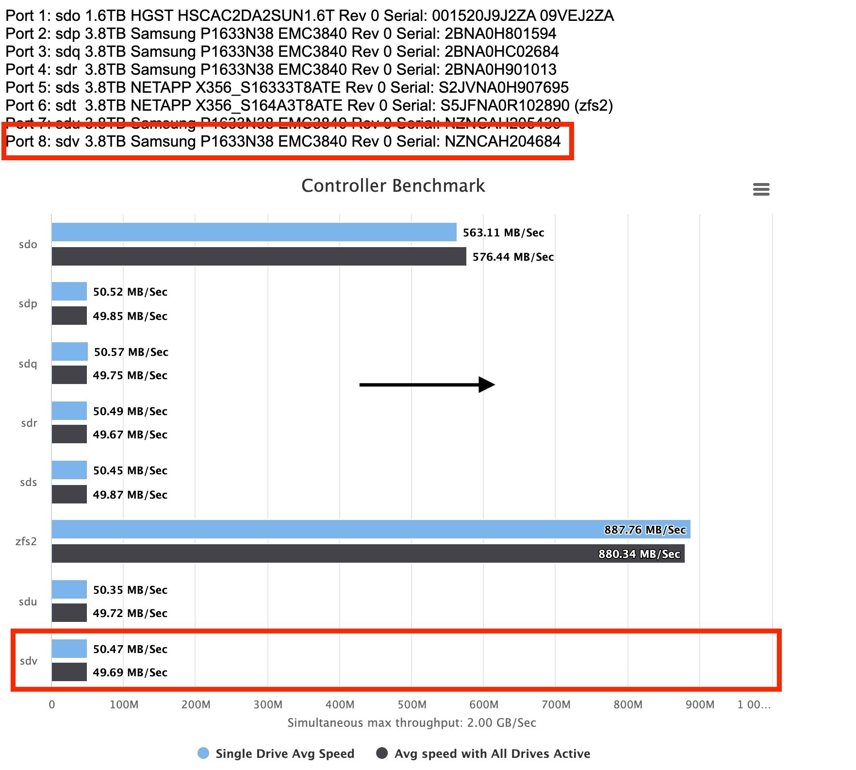

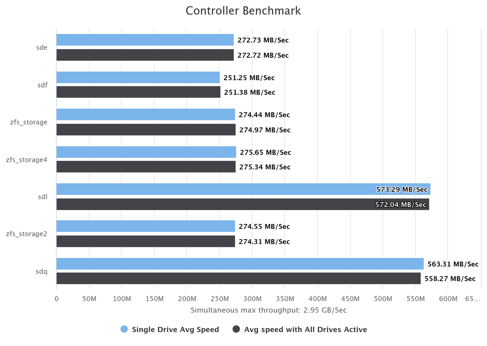

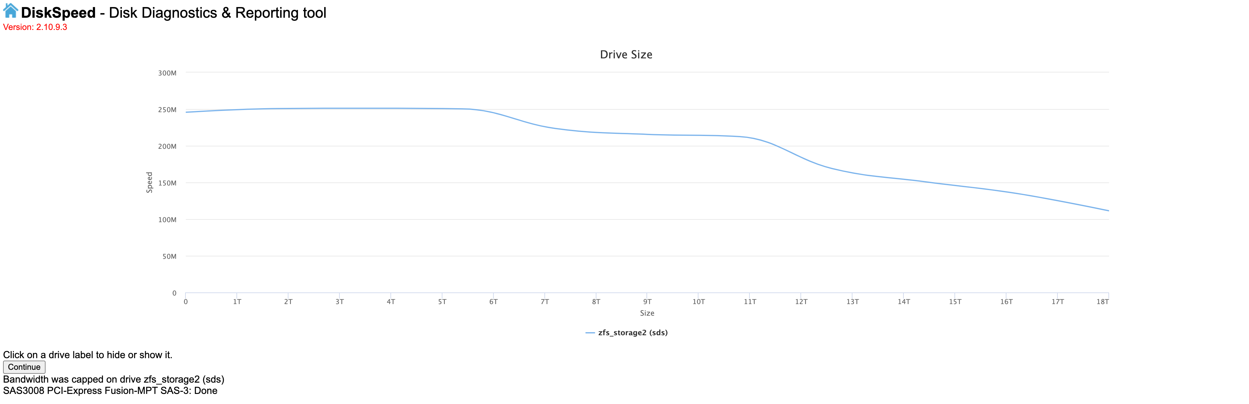

August 4, 20242 yr I am currently trying to copy aprox. 16TB of data to my truenas VM and it is terribly slow. I currently have the TrueNAS share mounted via SMB and I'm trying to copy all of my data from my "zfs_storage" pool to a different pool within TrueNAS so I can recreate the "zfs_storage" pool in TrueNas. Using the Disk Speed docker, I speed tested one of my 9 12GB SAS SSD's (pic attached) that make up my "zfs" pool but it only got ~45MB/s. This is terrible IMO. I did the same test on one of my "zfs_storage" pool drives (seagate EXOS 18TB) and got ~250MB/s peak and a little over 100MB/s towards the end of the test (pic attached). All my SAS Drives are on my Broadcom LSISAS9400-16i and all SATA drives are on my LSISAS9300-16i. My transfer speeds are frequently less than 15MB/s but peak around 60MB/s. The data I'm moving is on the "zfs_storage" 18TB spinning drives that tested at over 100MB so I would expect the data to transfer faster than that. I also tried mounting TrueNAS as a NFS share but that was the same in terms of speed. tower-diagnostics-20240804-1335.zip

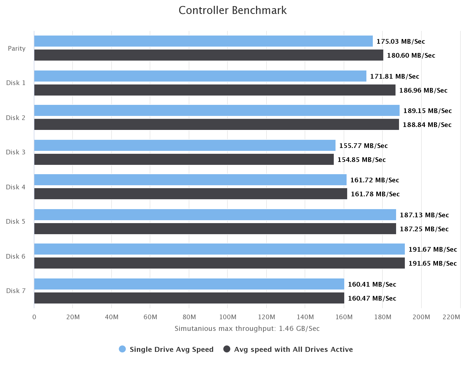

August 4, 20242 yr Community Expert Also do the controller test with diskspeed and post the results, the one that looks like this:

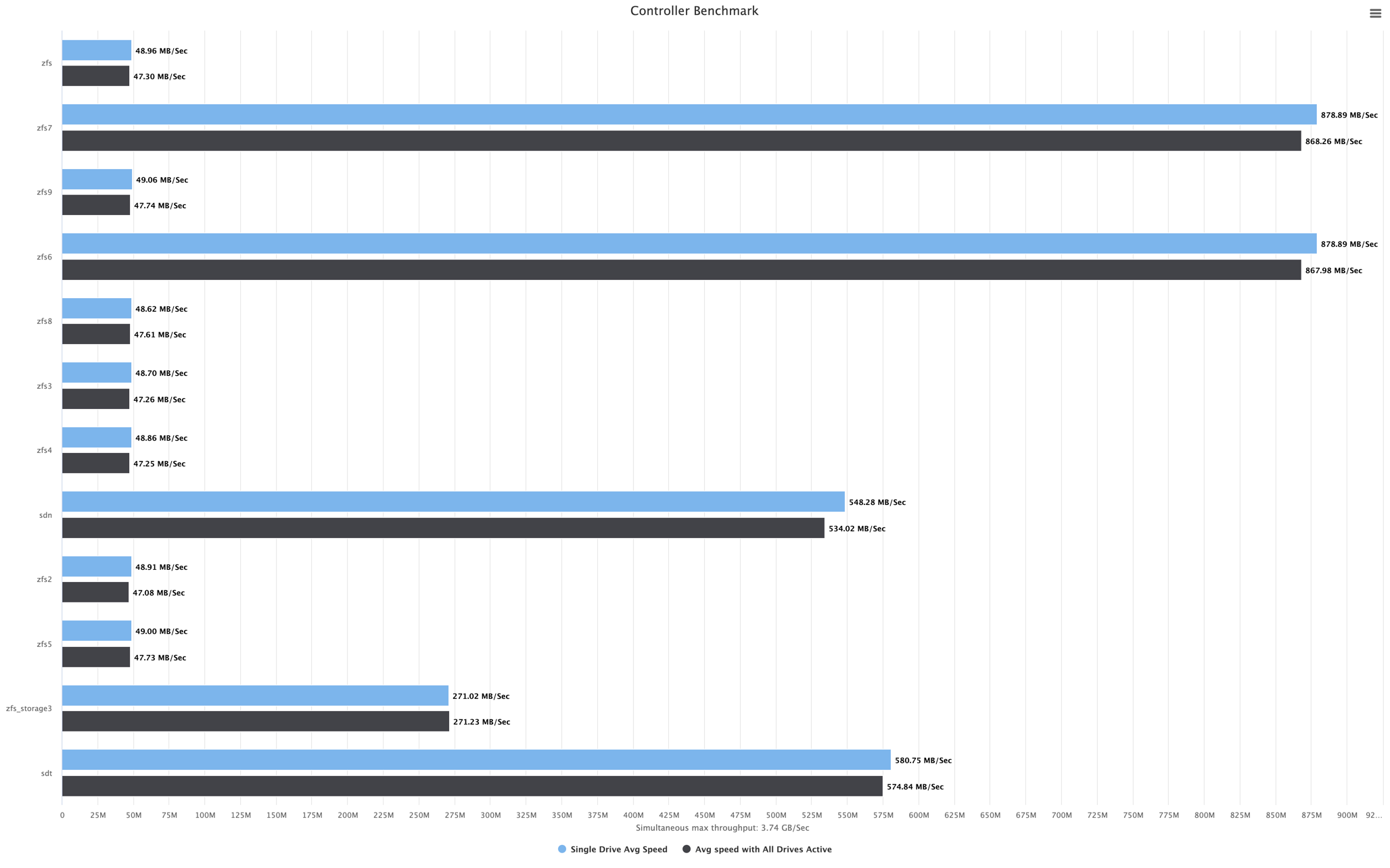

August 4, 20242 yr Author 19 minutes ago, JorgeB said: Also do the controller test with diskspeed and post the results, the one that looks like this: I wasn't aware there was a test for the HBA but here are the results

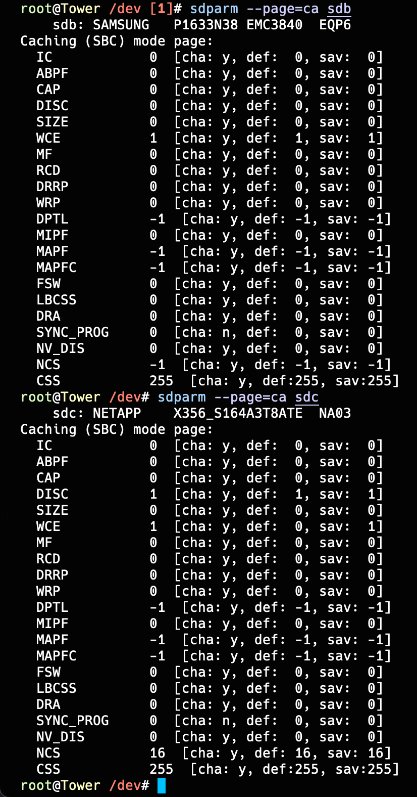

August 5, 20242 yr Author After looking at the results above, I decided to use sdparm --page=ca "drive" and compare the results I'm not sure what the "def" column is but I noticed that they are different. The drive "zfs" which is slow is drive label "sdb" and "zfs7" is drive label "sdc".
August 5, 20242 yr Community Expert Well, doesn't look like a controller problem, if it were just writes could be write cache disabled, but it's showing slow reads as well, so not sure.

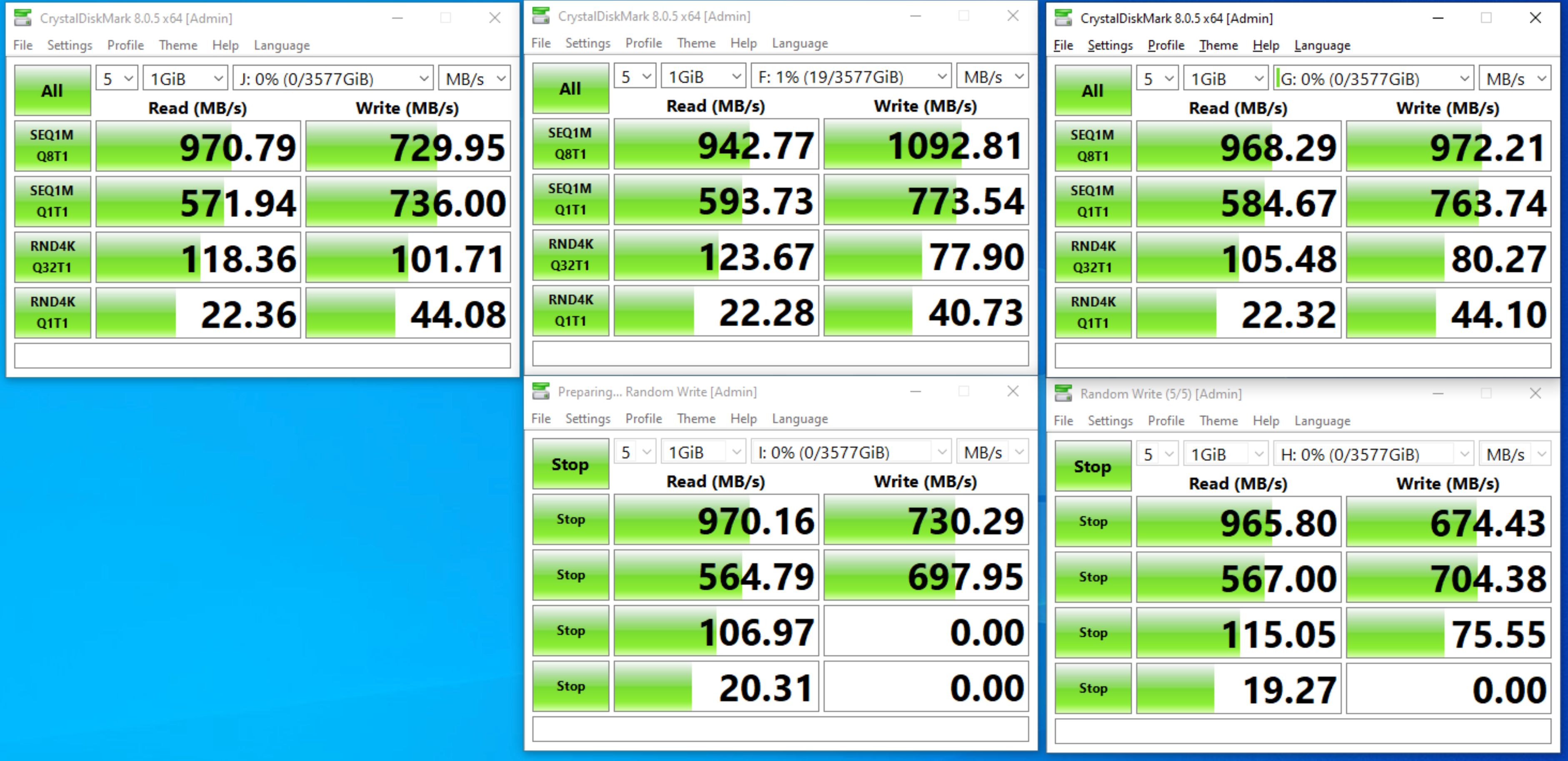

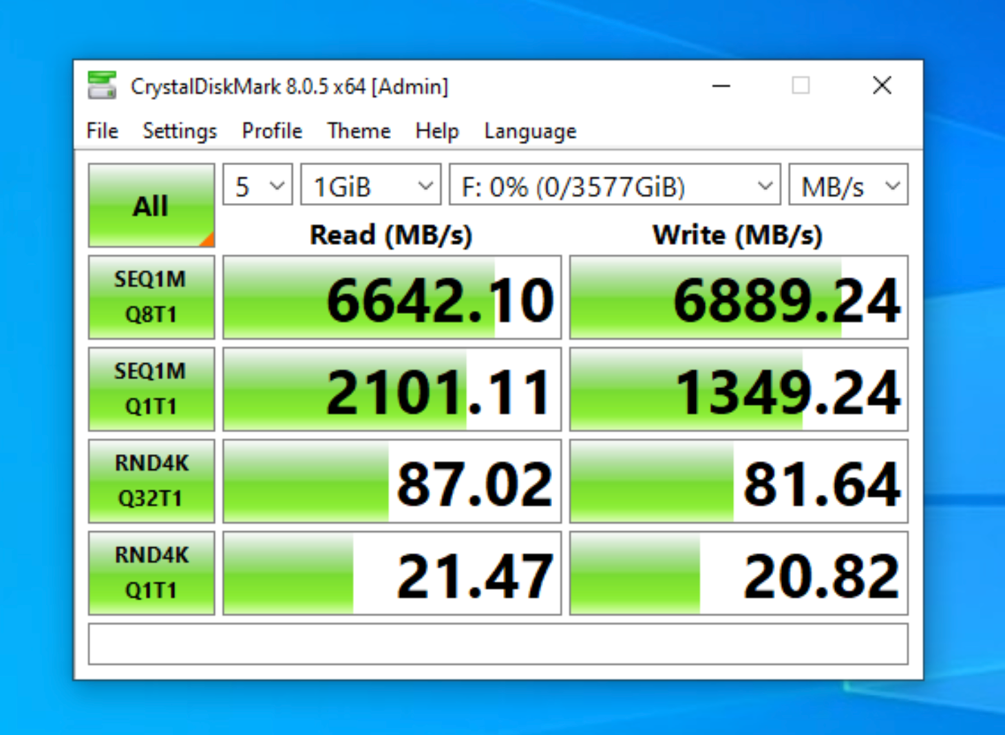

August 11, 20242 yr Author I attached two slow drives at random to a windows VM and ran crystal disk mark on them and the here are the results. Does this mean my issue is coming from Unraid itself? Windows can write to the same disks many times faster than Unraid. Unraid writes at 49MB/s and windows writes at 6,600+MB/s?

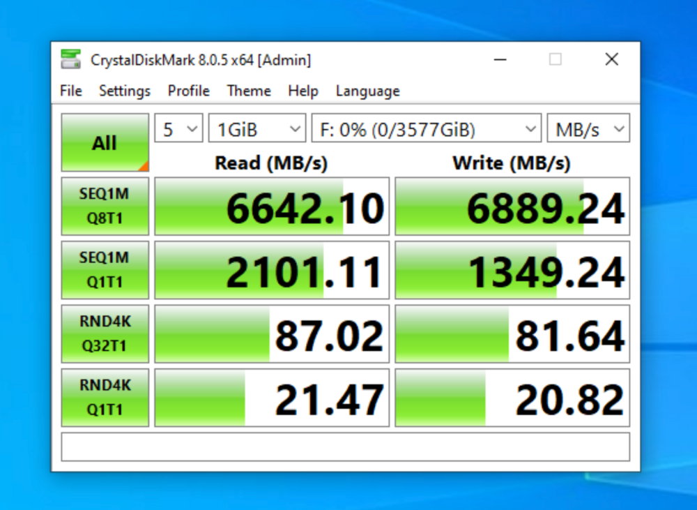

August 12, 20242 yr Author I passed the HBA to the windows VM and tested a few drives. Results are closer to what I expected and what I would expect Unraid to be able to do. It just seems that Unraid is missing something to be able to use the drives natively. Can someone chime in on what I should do?
