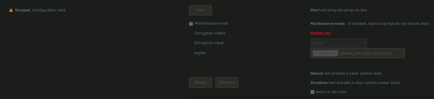

August 7, 20242 yr Author This is what it looks like at boot. I've now moved all data from a location it's been rsyncd to, to a location the gui file mover has moved it to, I also attempted exporting tank manually, this also didn't work. REDACTED Edited August 7, 20242 yr by Blazer8108 Removing screenshots for to avoid showing my domain.
August 7, 20242 yr Community Expert Solution 4 minutes ago, Blazer8108 said: This is what it looks like at boot. Not sure I'm missing something, but that is normal, with encryption enabled, you need to enter the passphrase/key after every boot
August 7, 20242 yr Author Seriously? That wasn't my experience before copying data. Before I could reboot and I could just click start and it would mount the drives.
August 7, 20242 yr Author 30 minutes ago, JorgeB said: Not sure I'm missing something, but that is normal, with encryption enabled, you need to enter the passphrase/key after every boot You are indeed correct. Apparently, I missed this bit in the documentation... https://docs.unraid.net/unraid-os/manual/security/data-encryption "Once you have set up encryption then it will be necessary to provide the encryption key when starting the array. " That's going to be pretty annoying... Thanks for the assist!
