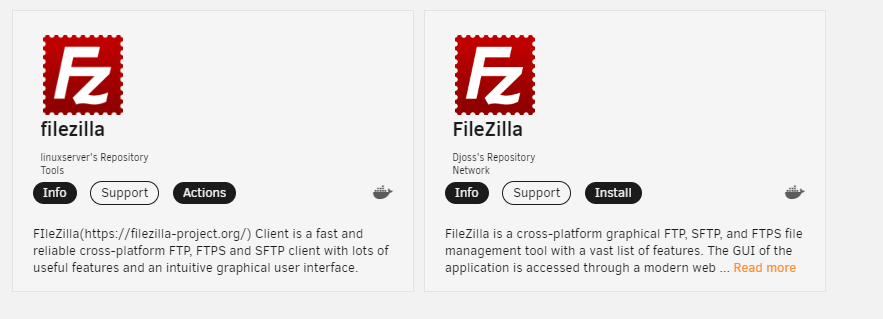

Other option manual intervention..
enable ssh on the backup unraid.
install the filezilla docker. and use sftp to connect to and send the files...
