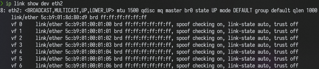

Recently, I bought a Intel T350-t4 NIC and tryed to use SR-IOV on it. I enable SR-IOV on eth2. And I also have a on board NIC(eth0). I bridged eth0 and eth2, and passthrough VF0 to VM.
image.png.6e44596f3a825d8e3e07c9d3924f8b90.pngimage.thumb.png.e6188e73e02908aee922c8ee74eab74d.png
The problem is when the bridge on, unraid cannot communicate to VM. If I cancel the bridge on eth2, everything works fine then.

I tryed the solution in that links (type 'bridge fdb add 5c:b9:01:00:01:00 dev eth2' on unraid's terminal), but it didn't work for me.

Late, but the thread is unanswered and the command you tried is very close to
the right one - I think it was pointed at the wrong address.
What is happening: with SR-IOV on, the card runs an internal switch between the
PF, the VFs and the wire. It does not learn addresses; it delivers to the ones
it has been told about, which are the VFs' own and the PF's. Unraid's own
address lives behind br0, and the card has never heard of it. A frame from the
VM to Unraid is a miss, and a miss goes out of the physical port instead. That
is also why removing the bridge fixes it: without br0 in the way, the address
the VM talks to is the PF's own, which the card does know.
The address to register is the one behind the bridge - Unraid's, the one br0
holds - on the PF:
bridge fdb add <mac of br0> dev eth2 self permanent
ip -br link show br0 prints it.
If the MAC you used (5c:b9:01:00:01:00) was the VM's, that would explain the
result exactly, and it is worse than doing nothing: it tells the card that the
VM's address sits on the PF vport, so traffic arriving from the wire for the VM
stops reaching the VF. Worth removing that entry if it is still there:
bridge fdb del 5c:b9:01:00:01:00 dev eth2 self
Then the test that settles it in a minute:
1. from the VM, ping Unraid - should fail
2. bridge fdb add <mac of br0> dev eth2 self permanent
3. ping again - should work
4. bridge fdb del <same> dev eth2 self - should fail again
One caveat I would rather say than have you find out: I have reproduced this
failure and this fix on ConnectX-4 Lx, ConnectX-3 Pro, 82599ES and X710. I have
not tested an I350 (igb), so I cannot promise it behaves the same - the four
steps above are how you find out in a minute, and if step 3 changes nothing then
this whole approach is not the answer on your card.
