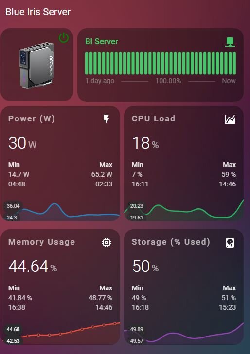

I also run Frigate (using a google Coral TPU) and BlueIris.  I am running frigate on a home assistant N95 nuc and BlueIris on another n97 based nuc (mini pc) so they are not running on my unraid server.  However, the n97 handles all of my 5 cameras easily in BlueIris.  2 of my cameras are 4k, and the other 3 are 2k.  As you can see from the image below, my cpu load is rarely an issue.  In fact, it seems to run around 25%-30% cpu load most of the time.
I would suggest you look at the structure between frigate and blueiris.  If you are like me, I use frigate for object detection and alerting (with the coral tpu).  I use blueiris for 24/7 continuous recording of the full resolution streams only.
If your use-case is similar to mine, I would suggest you look at blueiris and make sure you aren't doing ai or motion detection and have it set to direct record to disk (i.e. no transcoding).
