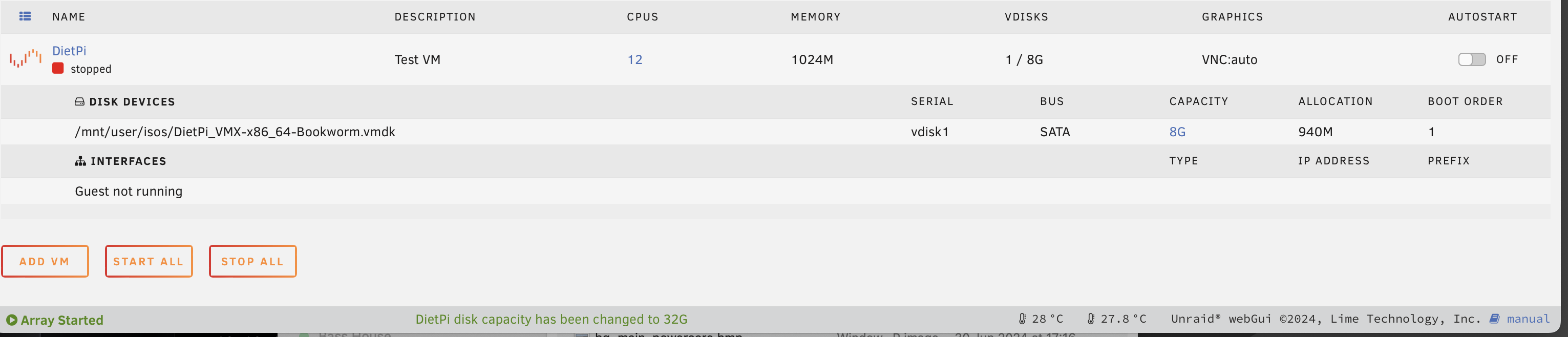

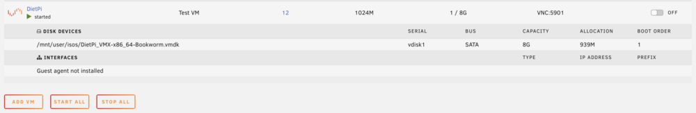

August 19, 20242 yr Hi, Pulling my hair out, could someone please advise? Ive created a DietPI VM using vmdk file. Everything has booted OK, however I am unable to increase the 8GB partition either via Unraid or within the VM. See below - VM stopped and when changing CAPACITY to 32G I get green confirmation, however it doesn't change. What am I doing wrong please?
August 19, 20242 yr Solution qemu-img can't resize a vmdk, would need to convert or use vmware to resize. Maybe best to download the qcow2 version (labelled for proxmox) or raw img version instead. Edited August 19, 20242 yr by Kilrah
