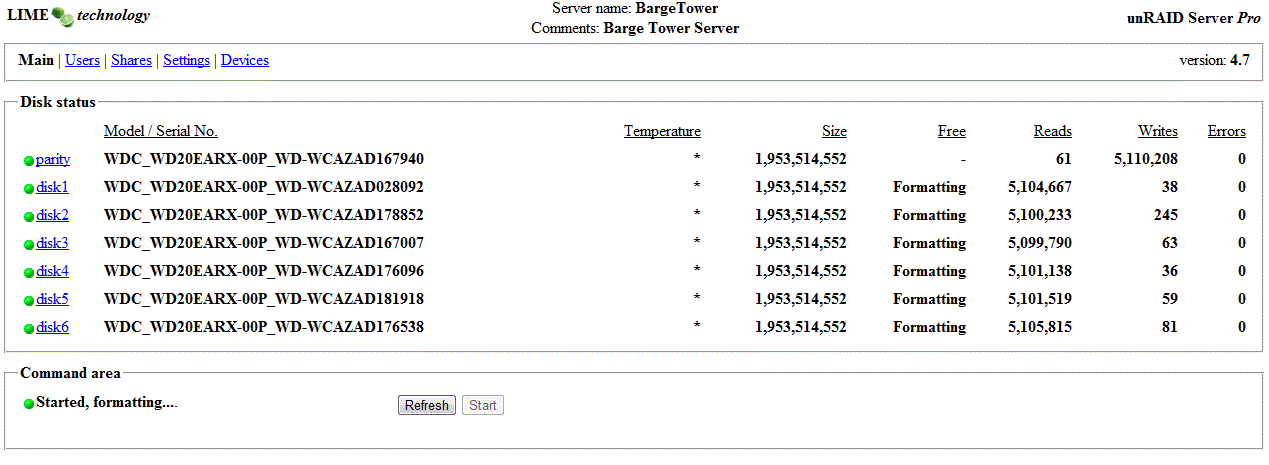

I am creating a brand new unRAID system with unRAID 4.7 and 7 WD20EARX hard disks (2TB) and am noticing that the formatting process is taking forever.
All the hard disks are empty, and the unRAID main screen process has created the Parity drive over about 10 hours but it now appears that the other 6 hard drives are just 'sitting' there in "Formatting..." mode, but they don't appear to be doing anything.
I had already precleared the drives using the -A argument with the 4K alignment option selected without the jumper on the drives, but for some reason unRAID has not detected that these drives have been pre-cleared, and the formatting process seems to be taking forever.
Just wondering if anyone else has had this problem and what to do about it. Should I force stop the array, restart unRAID and then try to have the drives formatted again?
unRAID Menu shows all drives as "OK" status and the parity drive being valid, but the drives are still perpetually in "Formatting" mode without actually doing anything.
Advice appreciated.
Cheers
Mike.

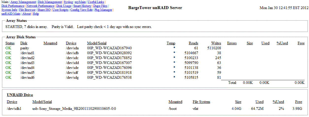

Hi folks,
Attached is my complete SysLog as of this moment.

I am concerned with some of the log entries particularly around 13:18:32 29 January where it says that there is "wrong FS type" - assuming FS = file system.
Also screengrabbed is my settings screen on the unRAID terminal, the main unRAID screen and the unMENU screen as well.
The hard disks are completely empty and don't have the jumper on them as per factory settings. They have also been pre-cleared with the 4K MBR option on.
Thanks for your assistance.
Cheers
Mike.

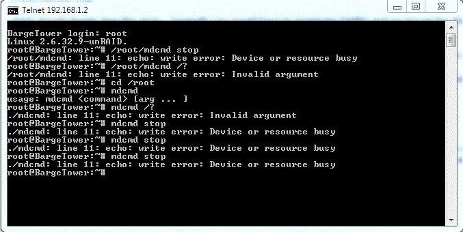

Hi Joe - sorry to keep coming back to you.
I cannot invoke the MDCMD STOP command from the command prompt after telnetting into the Tower.
It gives me the "Write Error : Device or resource busy"
Do I need to unmount or do something else in order to safely stop the system and then restart as per your other suggestions?
Thanks,
Mike.
