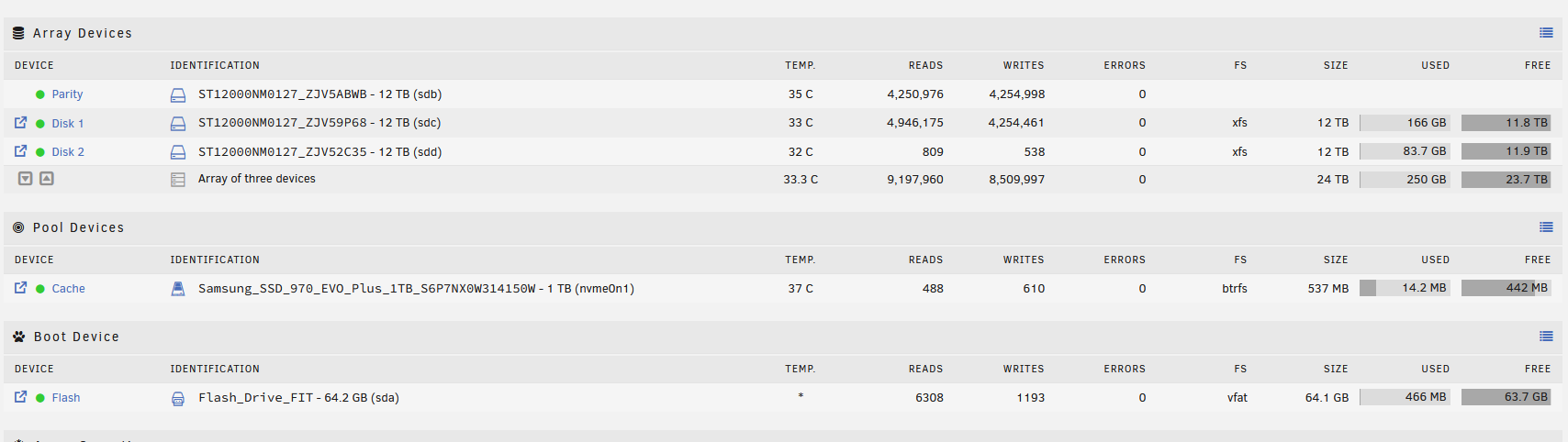

Hello,

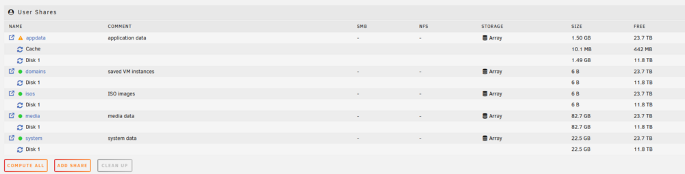

I wanted to add my SDD as cache for unraid to use it for the dockers (appdata) instead of having the disk spins all the time. But I don't understand what I did wrong, the size of the cache is 537 MB in btrfs, In Shares I tried to set it to first cache and second in array. I then tried to put it in only array to try format the SDD again but now there is still data in the cache :

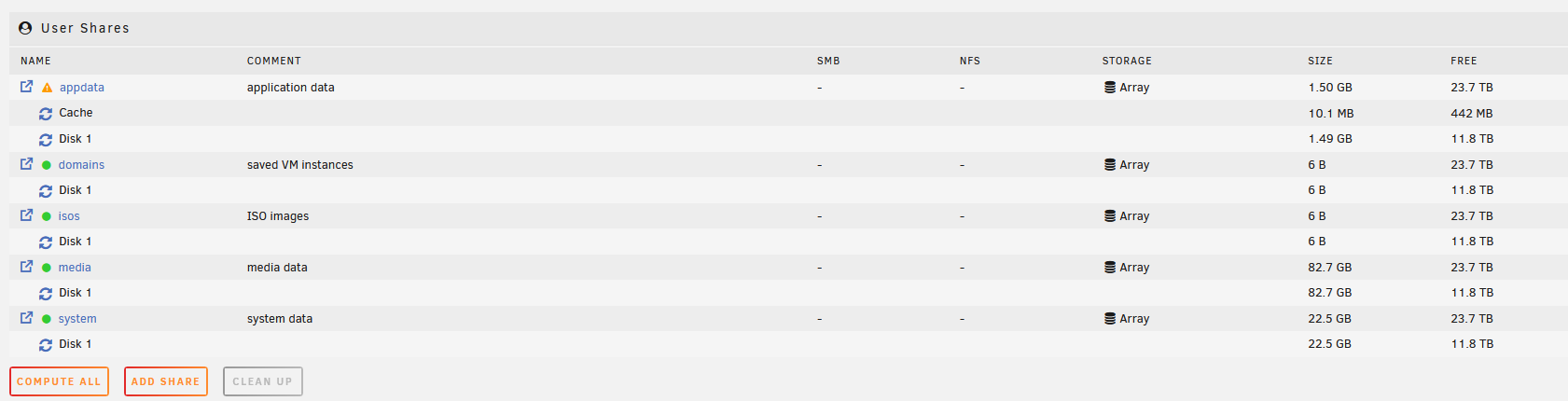

I tried to run the mover but there is still data on the cache. What should I do ?

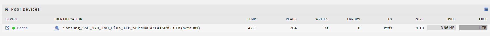

I assume there's no data there yet, if yes, stop the array, type
wipefs -af /dev/nvme0n1
then
blkdiscard -f /dev/nvme0n1
then reboot and reformat the pool again.
It worked thank you :)
