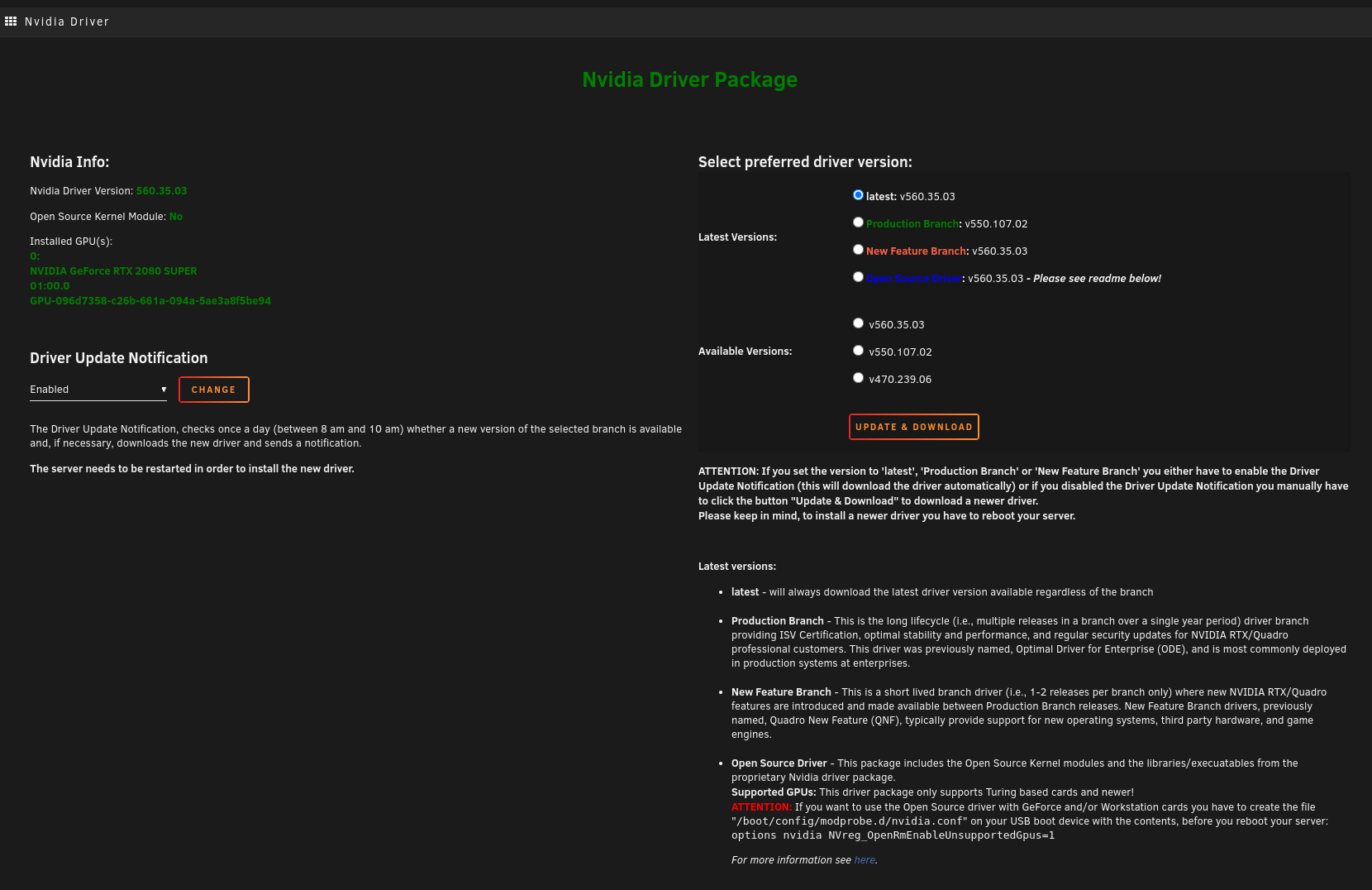

August 29, 20242 yr Helllo smrus852, just stumbled upon your post by chance. I run a setup with an NVIDIA 2080 Super and run Ollama, Open WebUI and Flowise without any issues. Unraid and the Custom Apps System allows for this very easily. There is a plugin which is called Nvidia-Driver which makes it dead simple to support Nvidia and Cuda and passthrough to docker containers. I attached a screenshot of the installed plugin and its settings. It takes like 2 clicks to install it. Hope that helps! Edited August 29, 20242 yr by Cyberschorsch Added a screenshot
August 29, 20242 yr Author @Cyberschorsch Thanks, thats mich easier than I expected. I read a bunch of post talking abouz using NVIDIA, but nome ever mentioned how they installed the driver. Just one more thing to be annoying about: With that driver installed, can mutiple Apps/Dockers use the same GPU or is it like a VM with complete passtrough?
August 29, 20242 yr As far as I know it is possible to use the same GPU for multiple containers but not for containers AND a VM but I think that is not a limitation by Unraid itself
August 30, 20242 yr Solution 17 hours ago, smrus852 said: With that driver installed, can mutiple Apps/Dockers use the same GPU or is it like a VM with complete passtrough? Yes, no issue with that. You can also look at the support thread here (first post how to install the driver <- seems more complicated than it is because the tutorial is really detailed, second post is an example to use the driver in containers like Emby/Jellyfin/Plex) : It is also possible to browse through the apps here: https://unraid.net/community/apps#r You can also register Trail here (30 day + 2 times 15 days extension if needed) : https://unraid.net/getting-started
