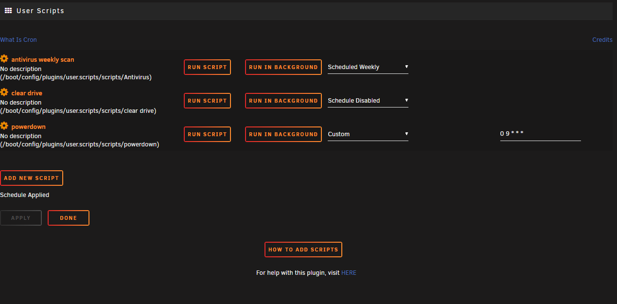

I am having an issue where my user scripts will not work/run ONLY when using a custom cron schedule. I only have 3 scripts. An antivirus script, clear drive script and a simple script to power down the server.
I first tried setting a custom cron schedule for the antivirus script, but nothing would happen. However, the script runs fine in the foreground, background, and by using the pre-defined schedule options (ie. at stopping of array, schedule hourly etc).
So I made a new simple script to power down the server and it too would do nothing when I had a custom cron schedule set. The script to power down the server contains the following:

I set the custom cron schedule to:
0 9 * * *
(9am every every day - I did try different times as well....9:05am, 11:30am - 5 9 * * * , 30 11 * * * , etc)
Nothing happens and no log recorded. To state the obvious, I made sure to set it at a time a well ahead of the current time, no joy!
However, when I click 'run script', 'run in background', or using the pre-defined schedule (I used 'at stopping of array' for testing), the script ran each time without an issue and the device powered down accordingly. A log was created as well.

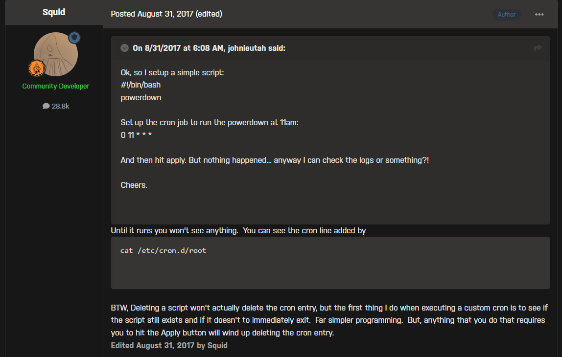

This image below I also ran the same command I added in my first post. I can see the last line shows my cron line added.
"until it runs you won't see anything". Not sure if this person had a different issue or the same issue but not explained properly.

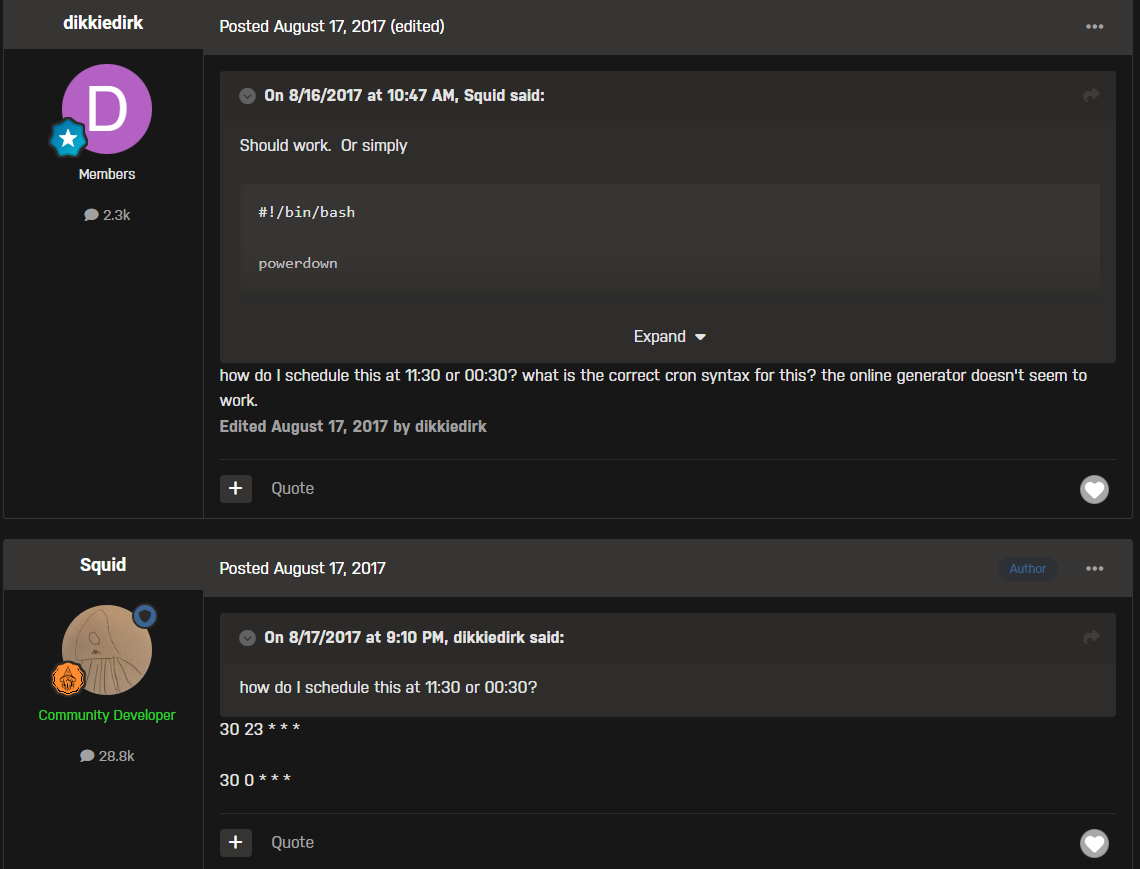

This one seems to be just a question. I assume they were having a similar issue as me but didn't go into detail or also forgot. Not sure:
This is exactly thew issue I am having. I have it set exactly as this, but does not work. Unfortunately, I wasn't able to see if they managed to get it to work:

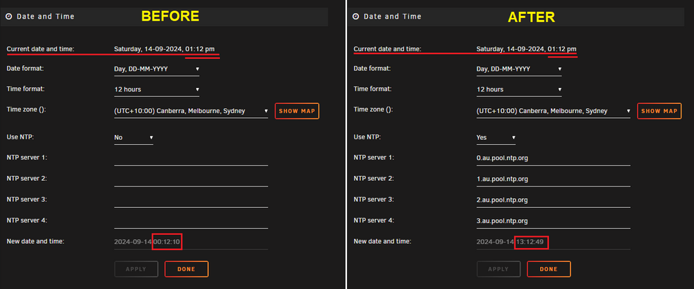

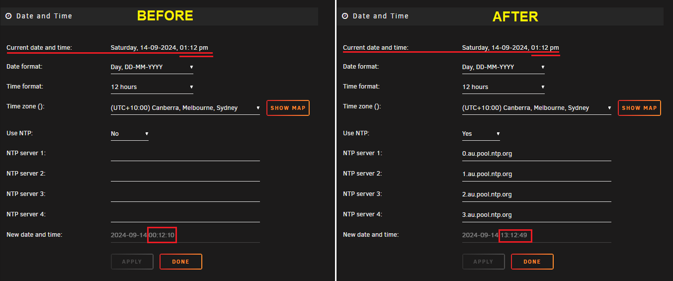

I managed to resolve the issue. For those who come across with the same issue, the issue was that the system time in unraid was incorrect - even though I had manually set it correctly.
What happened was I noticed my server was actually powering down, but not at the right time. So that made me think it has to be my date & time settings. So I checked them again for the 4th time, and this is when I noticed the issue.
The Time & Date were manually set, and correctly, but for some strange reason the "New date & time" at the bottom of the settings was not correct.
So I decided to use NTP servers to see if that made any difference....and it did! The time adjusted correctly!
I tested out my script again with a new schedule and BOOM - it worked!
Attached is an image of my settings before and after I made the changes:
