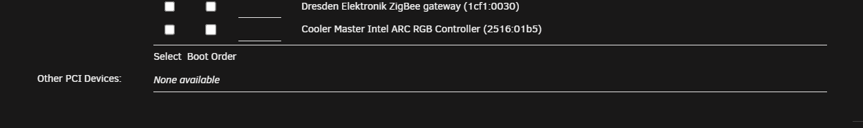

so to confirm are you passing the USB thru as a PCI device as nothing is showing in the otherPCI devs,
Not sure how to pass the USB through as a PCI device but I did bind the USB Controller (42) at boot just like the Video card:
image.thumb.png.b40a7e151b82bd0b427c0f57c5c60a2a.pngimage.thumb.png.4254b71a783000414878ad5d47db6a3e.png
Is there a particular log we can inspect or a screenshot I can provide? Maybe syslog but I doubt the error is there. When I look at the logs of the VM it looks pretty clean:

So does the PCI USB card shows in this section and you have selected the device? It may be the interupts are not getting thru to the card to say a new device is connected.
If you have a USB device connected at boot does it show in the VM? I guess you are only switching the KVM once booted?
You could try enable the unsafe interrupts.
You could try the USB_Manager plugin rather than doing PCI passthru as it supports auto hot plugin of USB devices into a VM.
Frankly, there is something with the VIDEO output and/or USB. Per the USB manager it found the Bluetooth but I cannot "VM attach" the Generic 4 port USB 3.0 hub. I think I will forgo using a VM at all with a dedicated GPU - not worth the trouble. I cant seem to find any sort of error or warning that something failed in the output (video/keyboard/mouse).
After I rebooted the server, when I switch to HDMI port 2, I do not see anything.. blank screen. (VM works ok via VNC ok mouse/keyboard ok)
image.thumb.png.5d69256205b69d052291c7a4d56effaa.pngimage.thumb.png.86a91a35962eec9d4164e16467dfaf02.pngimage.thumb.png.e5784b7e33d542cb7c7d9231a5a6507a.pngimage.thumb.png.972c6eafa39858a24503355422b5b779.png
