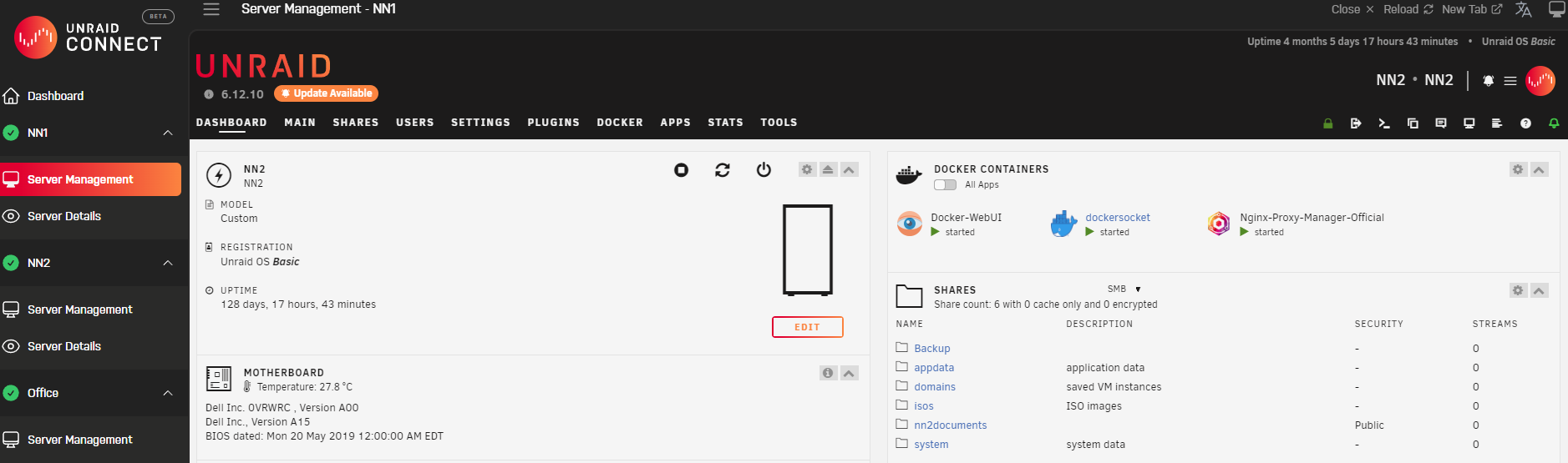

The Unraid Connect webgui is not allowing me to switch between my three servers.  It will connect to the first one I select then not switch to the other two when selecting server management for that machine.  I'm not sure how to fix this issue.

I've found no fix but at least a quick way to force the switch between servers.  On the dashboard, if you go to server details for the server you wanna see, then click on the refresh button a couple times then click on server management, it should switch to the server you want to look at.

I'm noticing the same issue as well. I had thought it was me at first, as I have just rebuilt a server into a new box, and I thought I'd messed something up, but now I'm sure it's a bug in connect.
While it makes management of multiple servers more difficult, if you go to the 'server details' page and view all routes, you might be able to swap to your other servers. While not perfect, it works enough until the issue is fixed.

The correct server is always initially loaded when the manage link is clicked, but then the first one automatically reloads replacing it.

I believe I've fixed this now! Please make sure to click on the "Reload" banner in Connect and report back if there are still issues.
It seems to be working now, at least for me just trying it.
