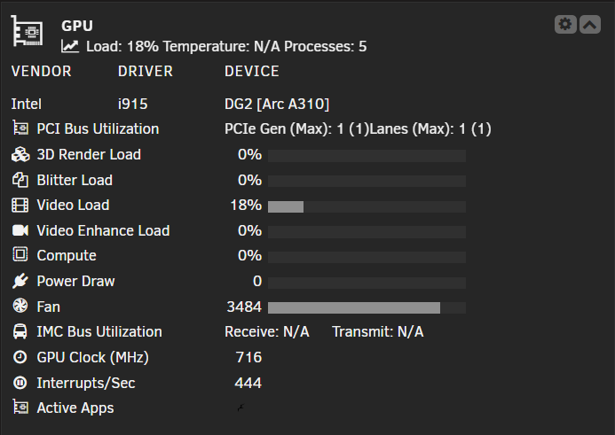

Hi guys, I have Intel Arc A310 installed in my Unraid system and everything is working fine, except I can't seem to see Power Draw and Temperature in the GUI, it's always displayed as 0 or N/A. Other stats display just fine.
Edited by Mitja
