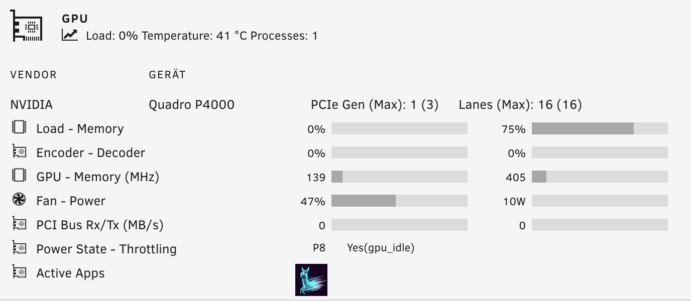

September 18, 20242 yr OK, I can confirm, that really did the trick. After rebuilding the image, the chat function works, and the UNRAID UI also shows that the P4000 is totally involved. 👍 Unfortunately the image is now bloated up to 60GB on my docker volume. I will post an issue on the localai github space and send the logs to mulder.
