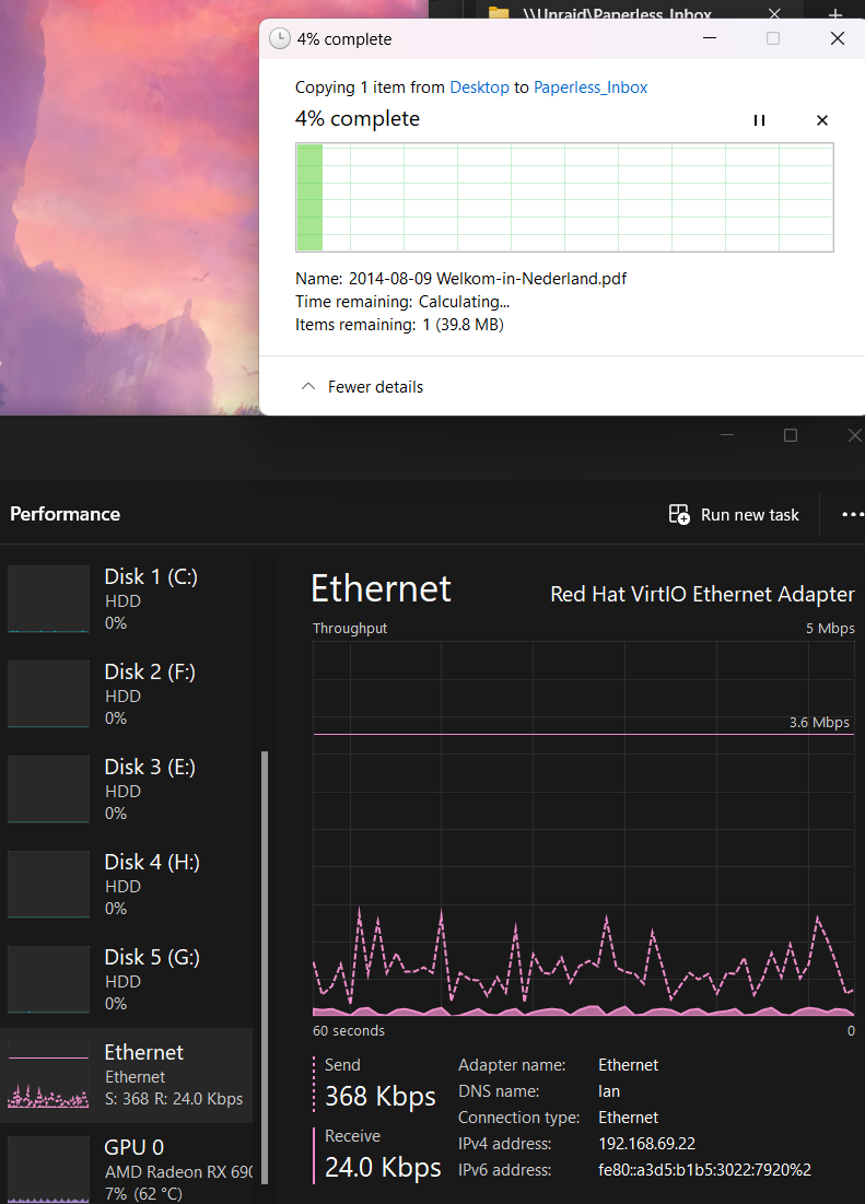

Hi all,
My issue: I can't upload any big file to Unraid from my Windows machine in a reasonable amount of time.
I see a speed of around 300 Kbps.
My setup:
Omada network with multiple LANs.
ProxMox PC (PC1) with Windows 11 VM. Bouth on LAN 1.
ProxMox PC (PC2) with Unraid and other VMs. ALL on LAN 20.
Android phone on LAN 1.
Windows 11 (PC1) installed with all necessary drivers from Proxmox and using best practices in configuration.
Unraid (PC2) has direct access to HHD drives, but Virtual to SSD. No issues there.
What I tried:
I moved PC1 with Windows VM to LAN 20 - no changes. Rolled it back.
Checked different settings on Windows trying with or Without a Firewall - no changes. Rolled it back.
Enabling and disabling LSO for outbound traffic - no changes. Rolled it back.
Trying different virtual Network adapters on my Windows VM - no changes. Rolled it back to the recommended option.
Tests:

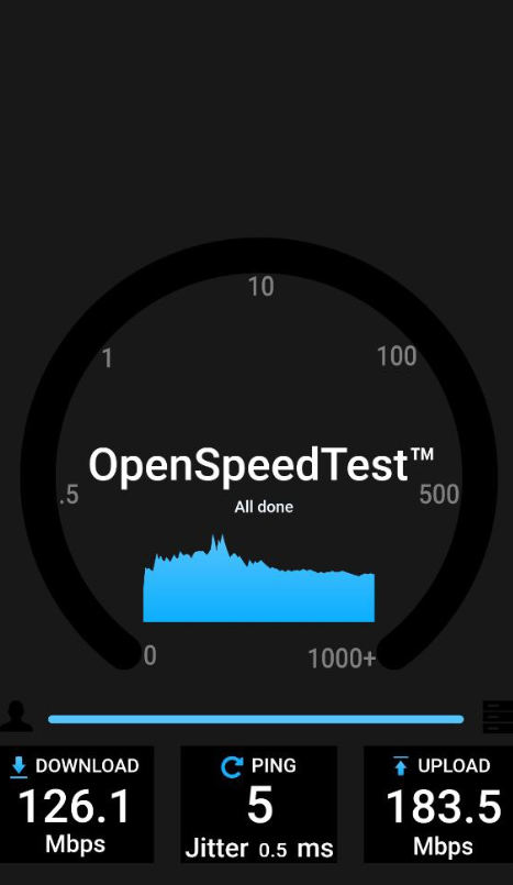

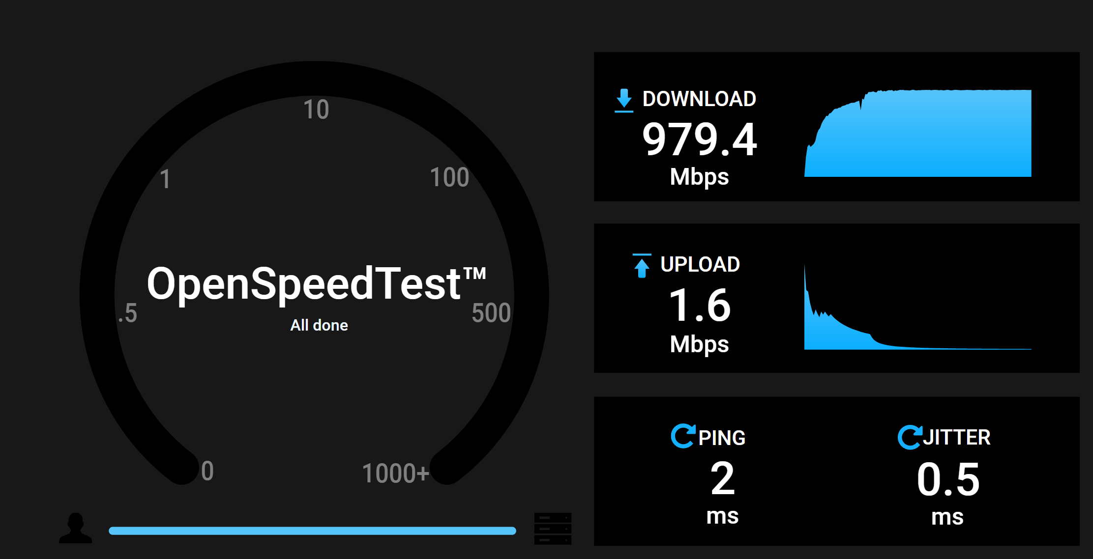

OpenSpeedTest from Windows VM(PC1) to Unraid(PC2)
OpenSpeedTest from Android mobile (same LAN as PC1) to Unraid(PC2)
My Note: Looks like a problem with Windows or somewhere in the middle of the connection.
But the problem is not because of different LANs for machines.

My Note: Looks like Windows 11 (PC1) doesn't have any issues with Media VM (PC2).
So, and now I'm completely lost.
I see that:
  1. PC1 has Normal speed to Unraid (PC2)
  2. Windows 11 (PC1) has Low speed to Unraid (PC2)
  3. Windows 11 (PC1) has Normal speed to Media VM(PC2)
  4. Android phone (same lan as PC1) has Normal speed to Unraid (PC2)
  5. Windows 11 (PC1) has Normal speed to public servers and SpeedTest (didn't add it here, because the post is already huge).
Because of points 1. and 3. It doesn't look like an issue in PC1 or PC2.
Points 1. 3. 4. and 5. show that it's less likely with internet equipment.
Points 1. and 4. show that there are no problems with Unraid (PC2).
Points 3. and 5. show that there are no problems with Windows 11 (PC1).
But if everything is correct why do I also have point 2?
Maybe I'm missing something obvious?
Do you need any extra information from my side?
unraid-diagnostics-20240921-1149.zip
Edited by kto
See the release notes, there's a kernel issue with virtio, try virtio-net for example.
Missed that.
Then I will wait for the next release, it's not a big deal. I found a few workarounds on how I can upload big files.
My Windows VM is on a ProxMox(PC1) machine, I tried to select a different adapter (E1000), but it's slower in general and didn't solve the issue.
