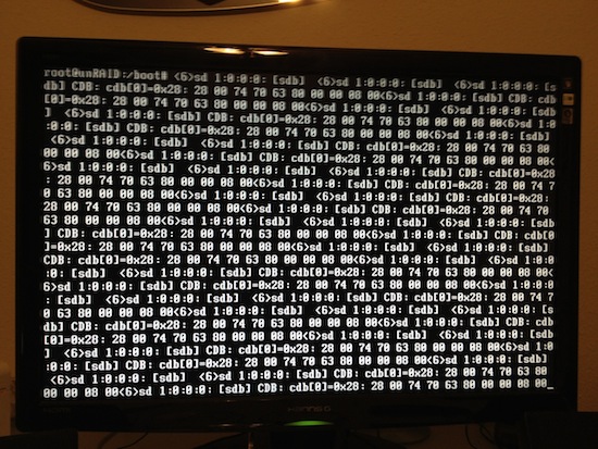

I'm just putting together my first unRAID machine.  Attempting to preclear 3 disks.  2 of them worked just fine, but the third behaves very strangely.  Instead of giving me the usual update screens and email updates (although it did send me the "start" email and the first "25%" email), it just fills the screen with endless amounts of information (see the attached picture.)
Using Screen I started this drive (SDB) at the same time as another drive (SDC.)  They're the same size.  I got both of the 25% emails at approximately the same time, but since then SDC has finished and SDB still seems to be doing something, though I don't know what.  It's now been 12 hours since SDC finished.  I tried preclearing SDB a few days ago and the same thing happened, so I stopped it using Ctrl-C and restarted it.  Same results that are still going now.  Any ideas?

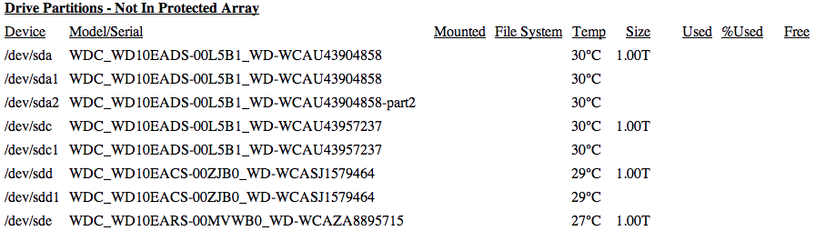

I noticed something that seems out of the ordinary in my list of drives on the management screen.  I'll post the screenshot here.  It looks almost like the drive that's giving me trouble is partitioned.  Am I reading that right?  If so, how should I procede?
Also I'll note that memcheck ran for 24 hours with no errors.
You don't need to do anything special.  Id does appear more and more that either you have a defective drive, or a power supply or cabling unable to supply proper power to it, or some other hardware issue.
