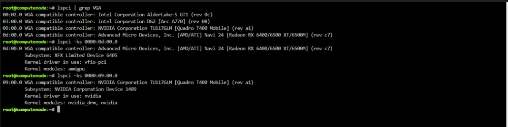

Your Nvidia card is bound to the VM so will not get any results in GPU stat. Here are my NV and AMD cards. AMD is inuse with the VM and bound to vfio not the amdgpu driver. NV is seen by the host and bound to the NV driver.

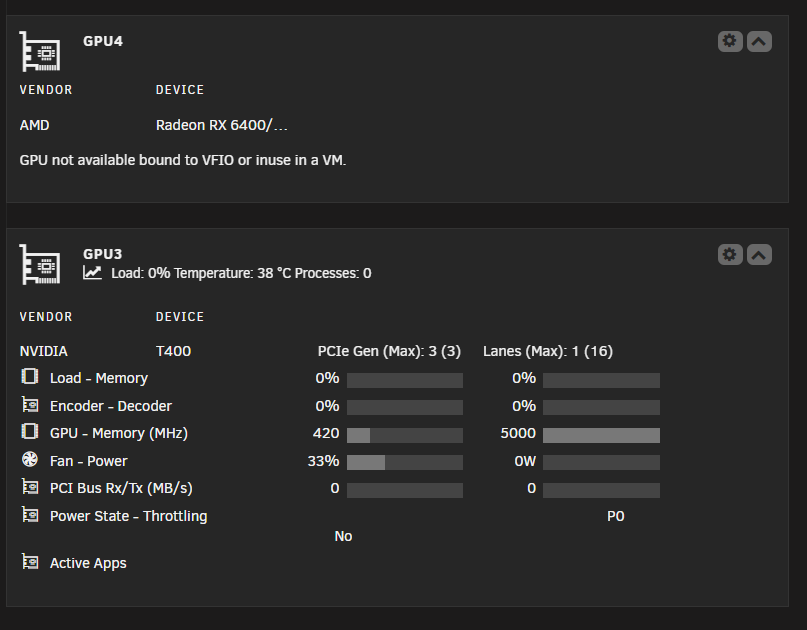

GPU Stats shows the following. GPU stats cannot show any data if it is in use in a VM.

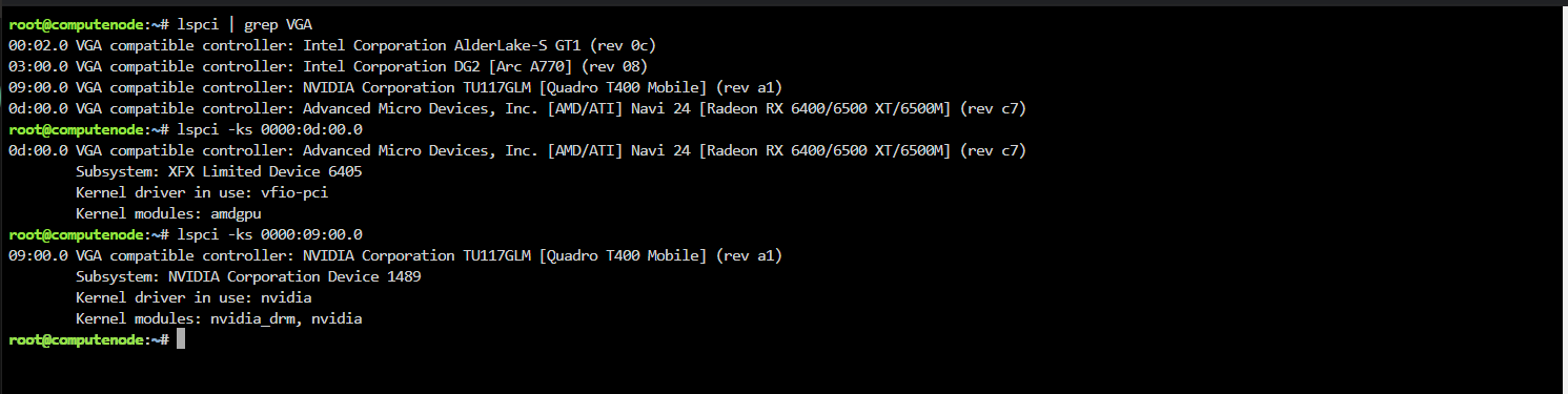

You Nvidia card is bound to the VM so will not get any results in GPU stat. Here are my NV and AMD cards. AMD is inuse with the VM and bound to vfio not the amdgpu driver. NV is seen by the host and bound to the NV driver.
