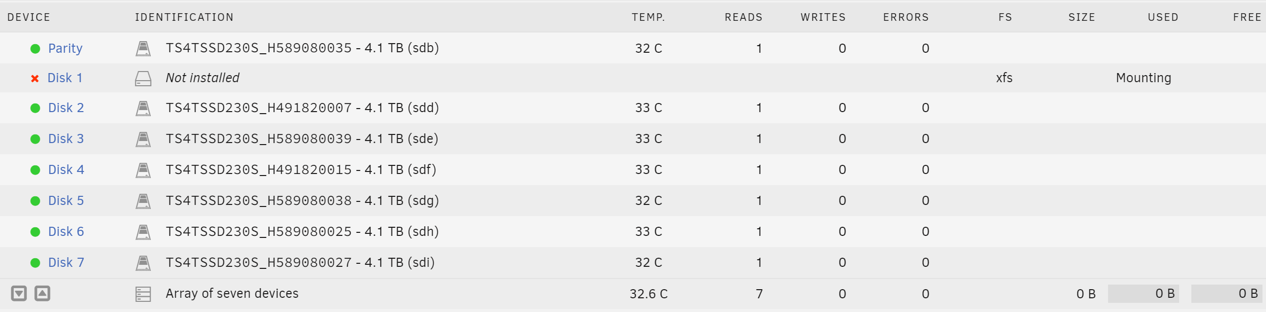

After the above, I plugged the drives back into my Unraid server and powered on. Ever since then, the server is always stuck at "Array Starting • Mounting disks...". The server always boots up in this state, and there's no option to "Stop", or start in maintenance mode. There's also no way to properly reboot or shutdown this server anymore: it seems that all attempts to do so would wind up stuck at something. And 1 thread of the CPU (5600X) is always stuck at 100% utilization
In this state, the parity disk is still shown as operational, but the data drive is stuck at "Mounting". So based on this, I unplugged the data drive and started the server again, and this caused "Disk 1" to show up as "Not installed", yet it's still stuck at "Mounting", see below:
Then regardless if I have this drive plugged in or not, the server seems to be stuck at this state.
