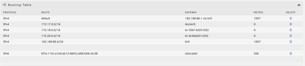

Also... I am somewhat suspicious of my routing table? It almost looks like docker is doing something weird with its networks... I tried to clean it up by removing the "none", but it eventually re-appears. This is captured when everything is working... I'll see if anything changes once the system breaks again.

you may need to do docker inspect commands. to grab the additional networking information.
docker ps
docker inspect <container id #######>
the br-### is created at boot and tells me that you have 2 dockers that make their own docker network bridge. (assumed)Probably a compose file.
Ideally, if running a reverse proxy like nginx, you want nginx to be running in the same subnet to be able to communicate and talk with each other.
Please confirm that you have unraid docker setting host access enabled to help with some of the ip routing you described:
looks like you have 2x 10 gb eth0 and eth1 as a network. it also appears you have bridging enabled?(if reading the diag logs right...). Based on the network you described, I would also enable bonding

ATM I don't see a problem with you networking or routes... What you have described to me is the ability for the docker... again due to dns / resolv config not be able to make it off and into the internet...
I Would advise if using compose to setup the networking to use your default created network bridge and not make there own bridge networks...
Thank you for sharing your docker network ls
6c9a6201c032 immich_default bridge local
55613d251b52 seafile-net bridge local
^ as theses may need to be removed and you run theses under the defualt network bridge that unraid provides so they can all talk to each other under 1 subnet....
^ this is also why you have 2 br-### as that is used to tap into and use as a network for it to get a ip and have network related servcies....
you may be dealing with a layer3/layer2 networking issues... as i think immich is a network based docker....
review post on the resolv config and set a custom dns to the dockers...
use a public dns like google 8.8.8.8 for testing....
