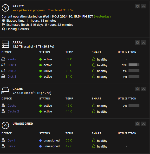

7. After drives were added, parity started, but I stopped it. I didn't want to wait two days for it to go through check then and was reading on how to increase parity checks speed or at a more opportune time. I came across and installed Parity Check Tuning. I left everything as default and started the parity check. I woke up the next morning to the server frozen with the parity check information I could see on the screen. I think it was 300 (something) days, at 200 (something) kb, and around 35 errors. Tried everything I could think of to try and reboot as safely as I could. I had to resort to a straight, hard power down.
8. I started the system and ran the parity check again—the same issue. The system had locked up with errors, and the parity check took a long time. I don't remember values because, at this time, I was a little frustrated. I started reading up on parity check errors, issues, resolutions, etc. After each of these steps, I ran a parity check until I noticed it was dropping from 200mb/s to 400kb/s and then stopped the parity check and forced reboots

9. I Ran another parity check and checked this morning to see this and finally decided to give up and post here:Screenshot2024-10-17092918.png.c9b38cea3b0e0d1d5db87b671f787501.png

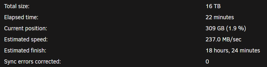

The current parity check is looking like this right now which I can live with and seems normal
