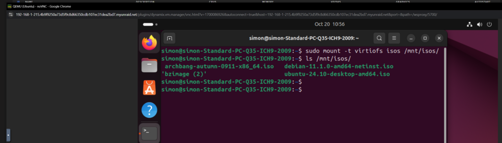

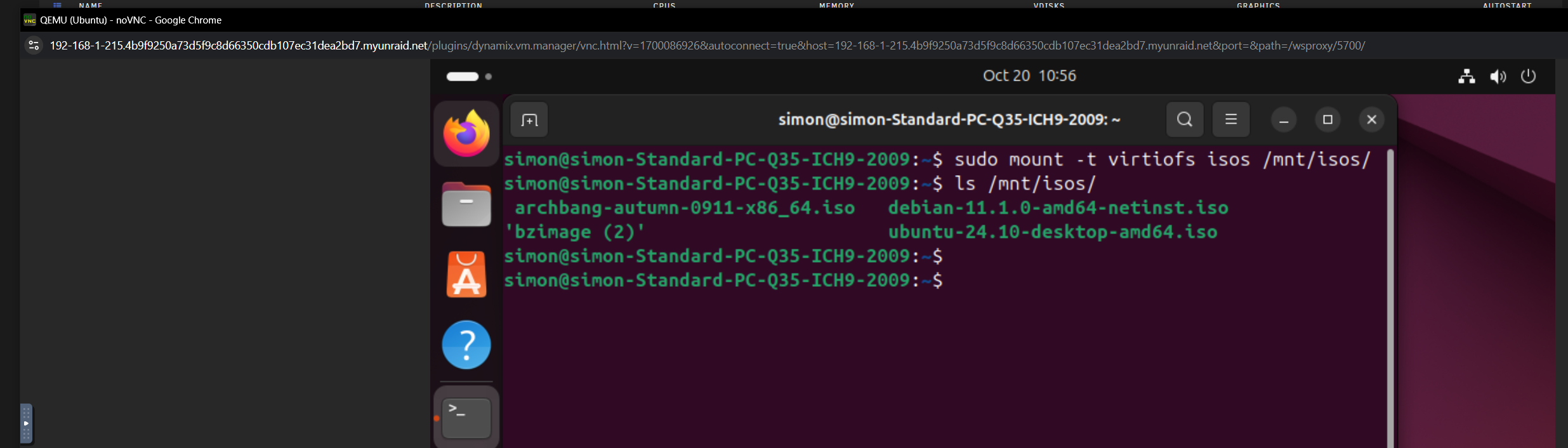

I cannot see any issue from Diags. I have created Ubuntu 24.10 on both 6.12.13 and 7 with no issues. I did find that VM did not install correctly with < 4Gb memory.
Once VM is booted I had to install virtiofsd and could map a drive. So have not been able to replicate yur issue,
