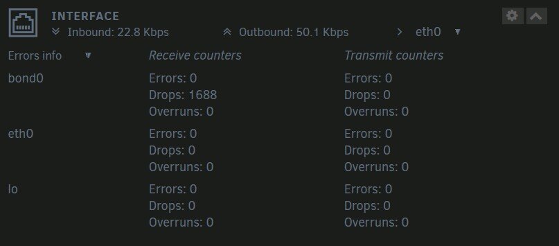

The device is getting many drops in the dashboard, so something is very wrong? (See picture)

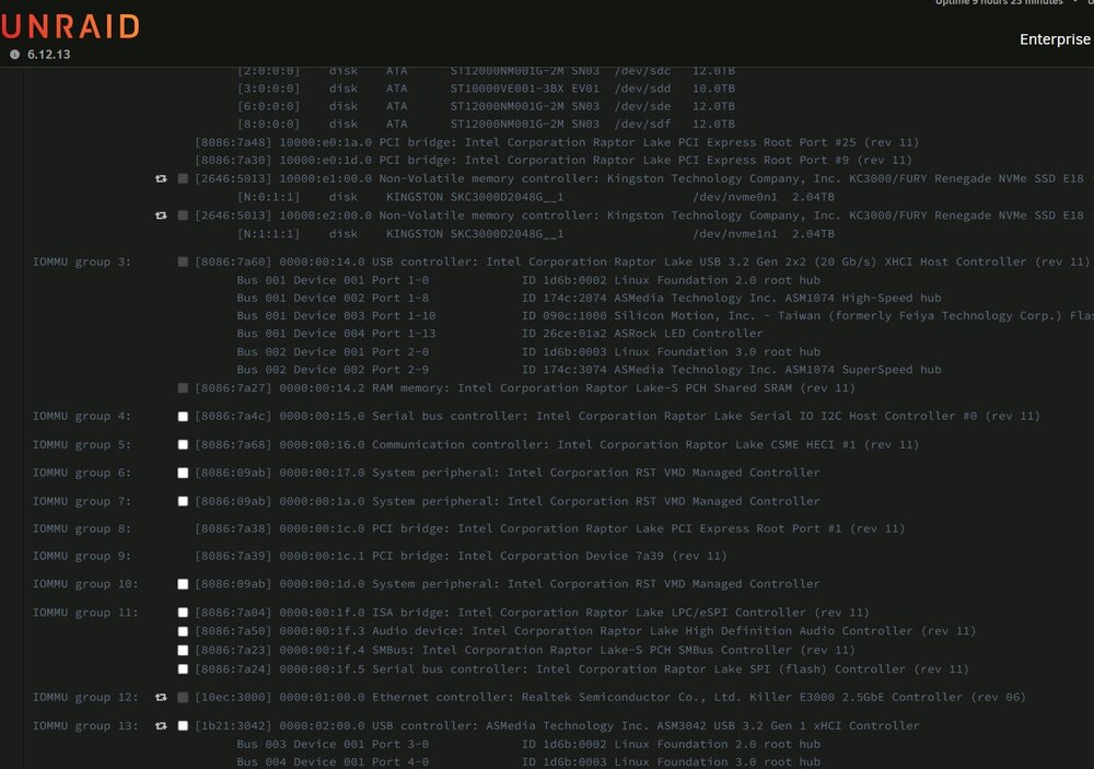

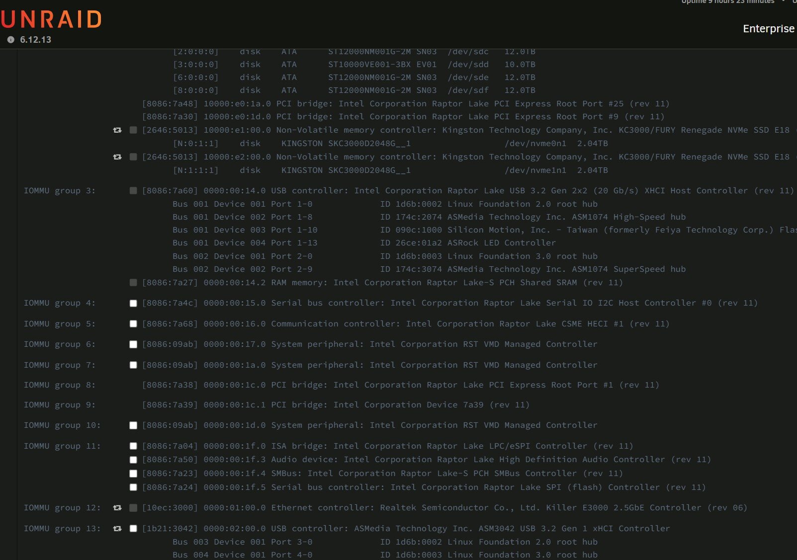

Device found by unRaid is: IOMMU group 12:[10ec:3000] 0000:01:00.0 Ethernet controller: Realtek Semiconductor Co., Ltd. Killer E3000 2.5GbE Controller (rev 06)
Question, is this not wrong version? should be E3100?
I've seen that the forum has had issues with RTL-8169 driver and suggest changing to 8125, but I'm new to this ,and would really like some confirmation. Or if unRAID could update this in coming releases?

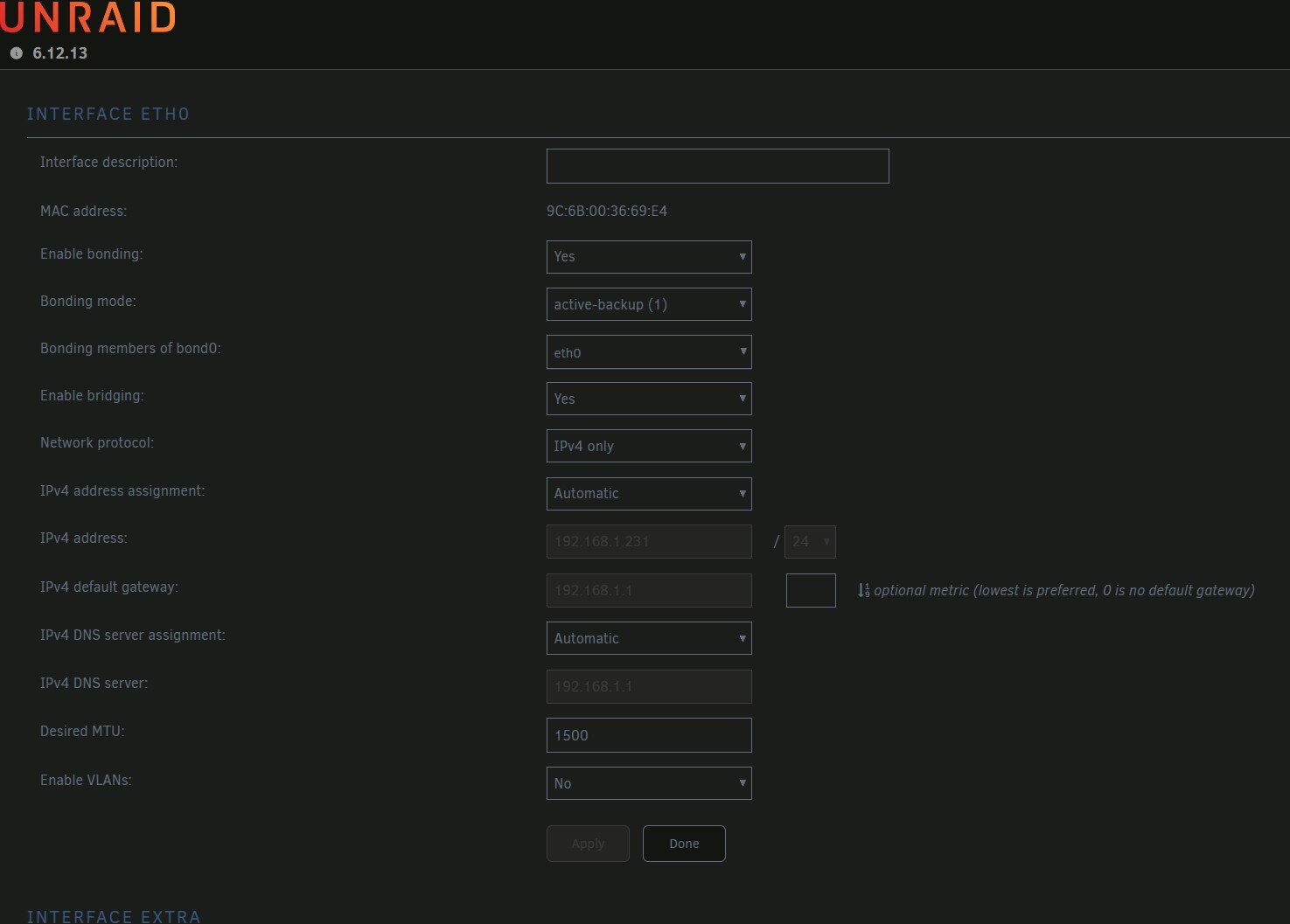

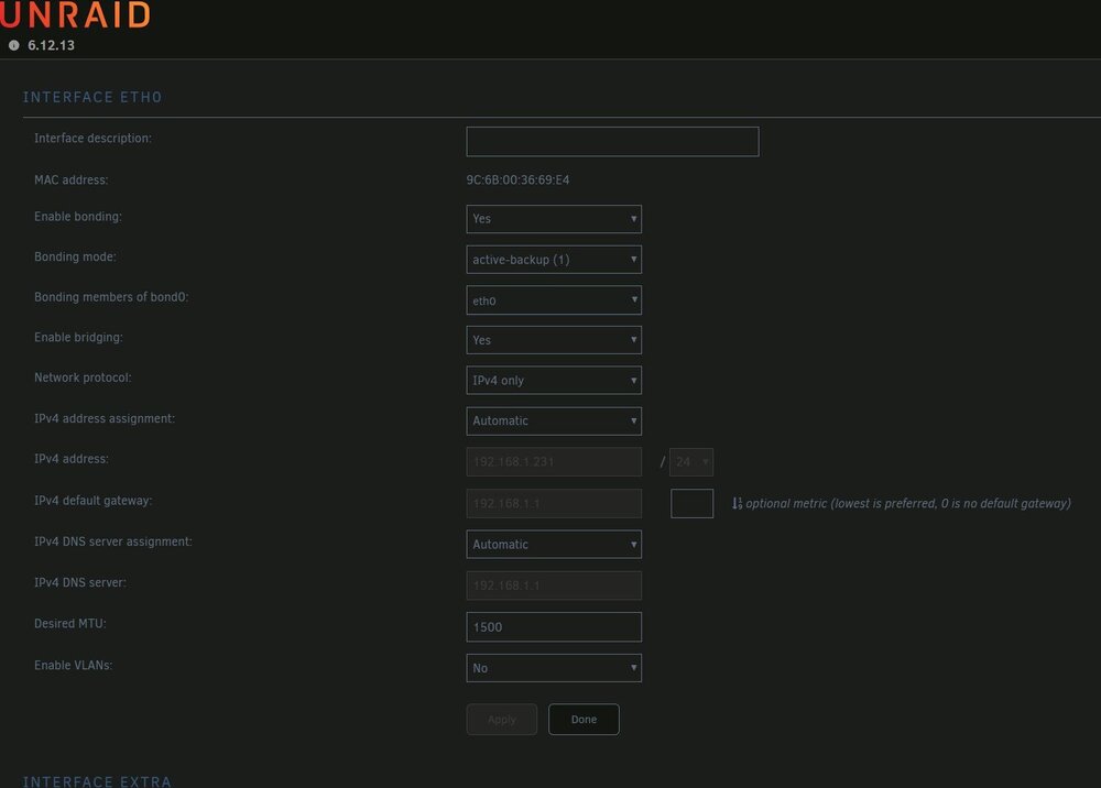

Network:bond0: fault-tolerance (active-backup), mtu 1500
