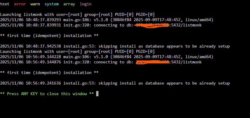

Hey I'm having issues getting this to run. I set up the database and everything but I'm stuck and don't know why it won't launch. The logs give me this:

Hey, sorry been super busy. Haven't been able to get it to work. The database gets populated, everything seems that it should work but it doesn't start.

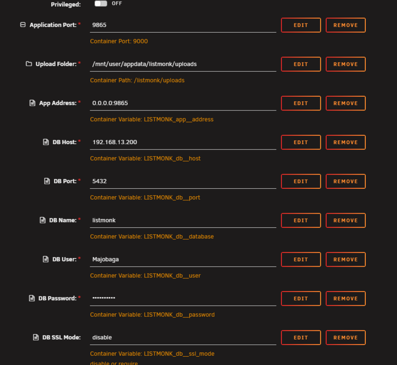

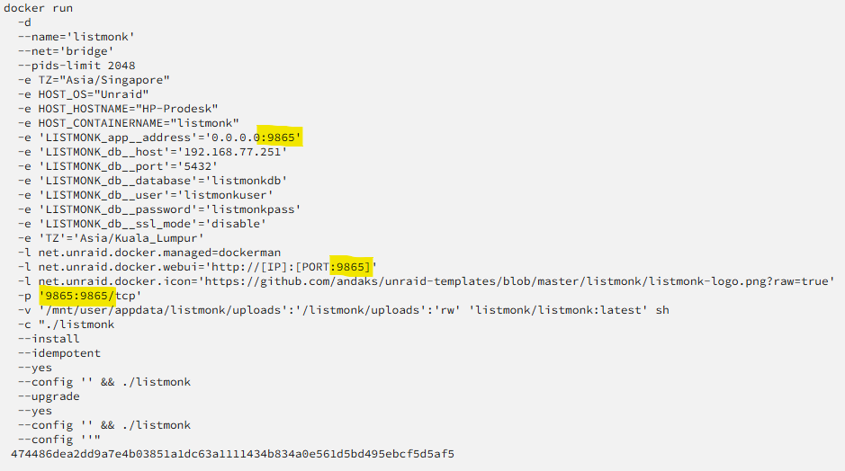

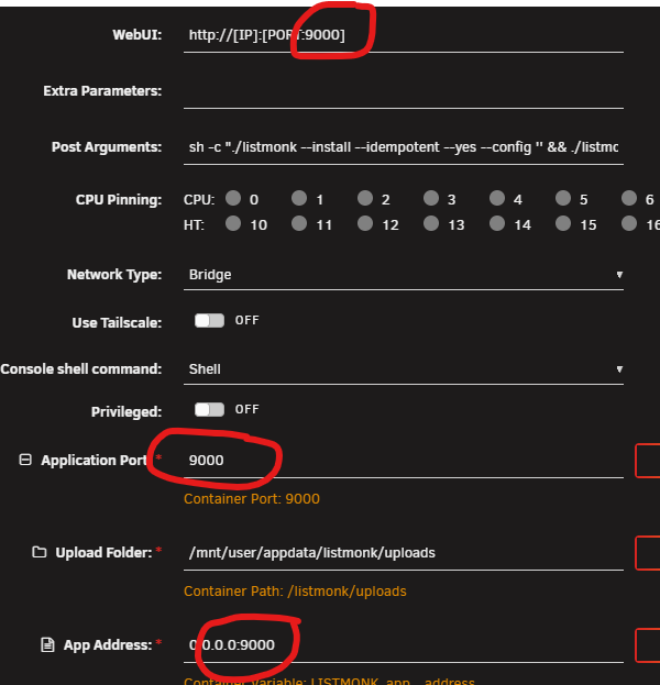

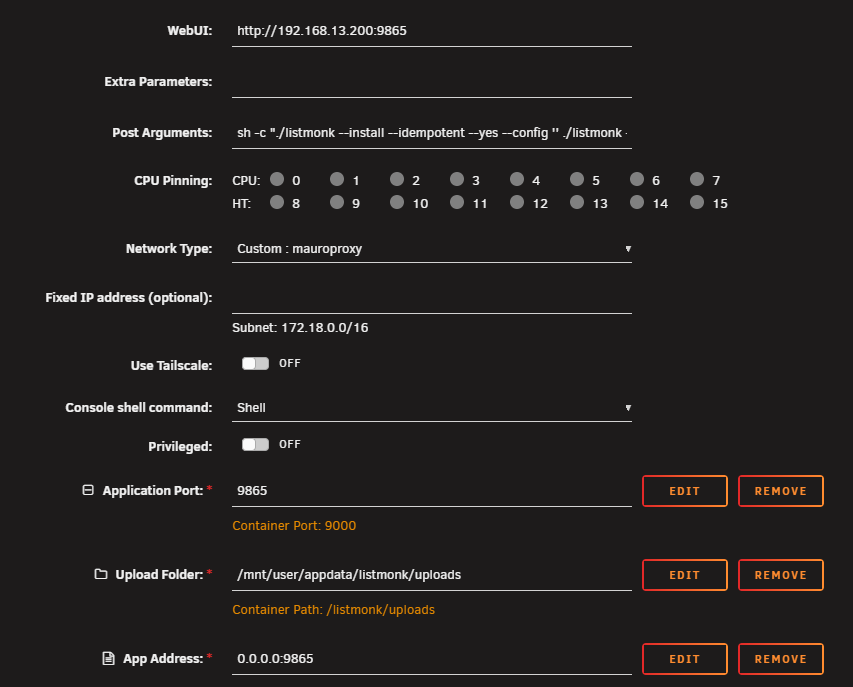

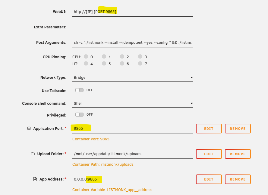

Hmm. since I don't have detail info such as log etc, I am unable to replicate the issue. I have tried at another unraid instance (means 3 different setup already) also don't have any issue. You might try to check port number setting as per image below. Also please check if your other container using the same port. Container do not start if failed to bind the port.
image.pngI
I have checked the ports and everything, no other containers are using it. I create the database in postgresql15 and 17 (I've tried with both). When I run the container the database gets populated with tables and everything, but then the container stops. I'm not sure if it's an issue with the database situation or with Unraid itself. When you've tested it, do you go ahead and create the database in postgres before you install the container or does the container itself create the database?
I think no issue with database since the database get populated. I believe this is related on port mapping.
Can you check application port by click edit button. Container port and host port should be change accordingly.
You can verify after that by applying the changes.
The ports are all fine as you can see in the screenshot. I don't think that's my issue, the container won't start. The database gets created and populated but the logs show that install go53 line.

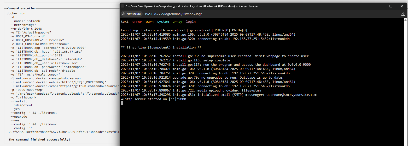

Can you screenshot as below
