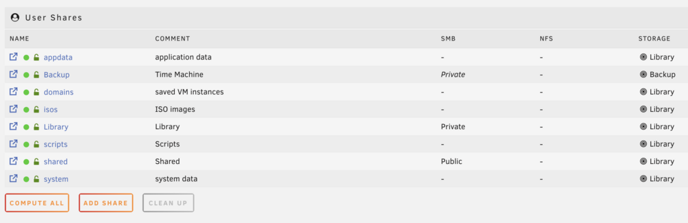

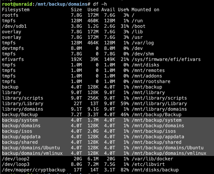

October 30, 20241 yr I have 2 pools, Backup (4Tb, 2 x SSD) and Library (22 Tb, 4 NVMe's). I initially set up the system shares (system, domains, isos and appdata) to be placed on Library because it's the largest pool. However, along the way, the system shares have automatically been moved to Backup, though under the Shares menu they are still showing as being under Library (see screenshot) and upon running `df -h` (see screenshot) they show up as being under Backup. What's the reason behind the automatic migration and, more importantly, how to permanently move them back to Library? unraid-diagnostics-20241030-1028.zip
October 30, 20241 yr Community Expert Solution They are all set to cache=only on Library, so it wasn't Unraid that moved them, possibly you started the array with the Library pool? To move them, disable Docker and VM services, set all those shares to primary=Library, Secondary=Backup, mover action Backup -> Library, then enable mover logging and run the mover. Note that if there are any duplicate files they won't be moved, also Ubuntu and vmlinux are nested datasets, so they also won't be moved, but they appear to be empty, post new diags after running the mover.
October 30, 20241 yr Author It works beautifully. Thanks for the help. After I ran `move start`, it migrated everything and left two empty folders in `/mnt/backup/domains`. I tried to remove them manually, but it ended in: root@unraid:/mnt/backup# rmdir domains/* rmdir: failed to remove 'domains/Ubuntu': Device or resource busy rmdir: failed to remove 'domains/vmlinux': Device or resource busy That's not an issue as they are empty, but will they be removed after a reboot?

October 30, 20241 yr Community Expert 1 hour ago, kevin.denver said: That's not an issue as they are empty, but will they be removed after a reboot? If /mnt/backup/domains is empty, and because there are nested zfs datasets, you need to use: zfs destroy -r backup/domains
