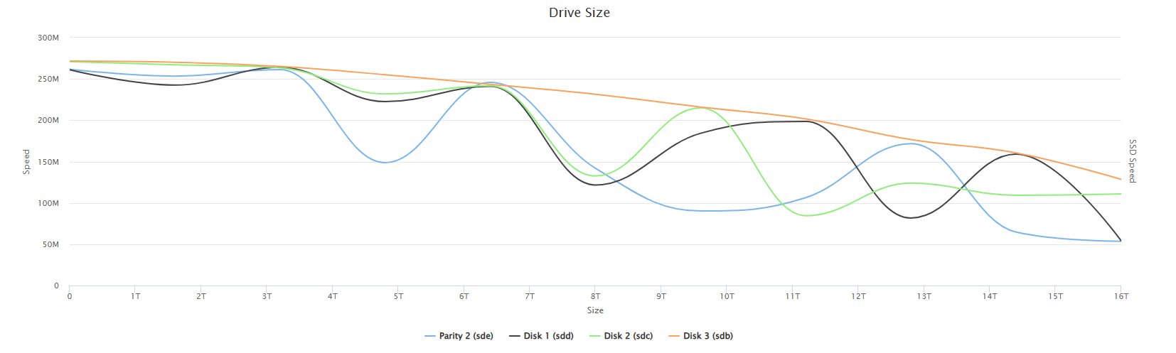

My Transfers to my Plex share are slow and inconsistent (see picture 1)

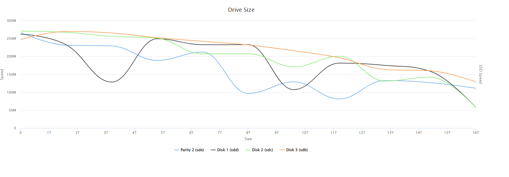

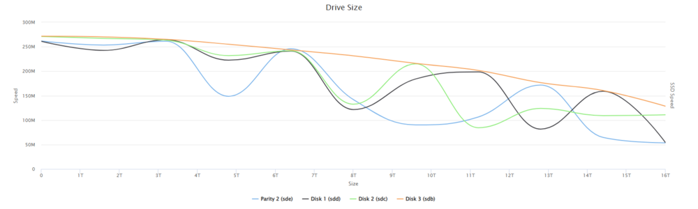

If I test the speed I got the following results (see picture 2 and 3. 3 was with "reconstruction write" on in the seetings)
I don’t know why this is so inconsistent
Write mode won't change anything since it's a read test only, the inconsistency could be due to disk issues, where some areas are slower, though kind of strange with new disks, I assume.
