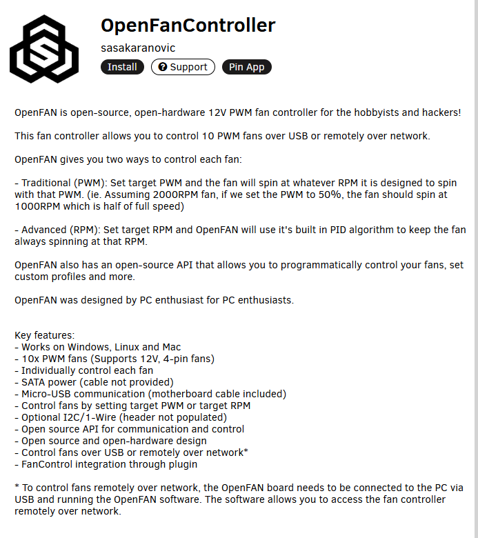

It sounds like you are running enterpirse hardware if fan control is what you need i would sugest this plugin to help dial the fans back:
Potential look into you bios / impmi depending on hardware...

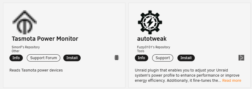

Otherwise, it sounds like you need autotweak to access other power options...
