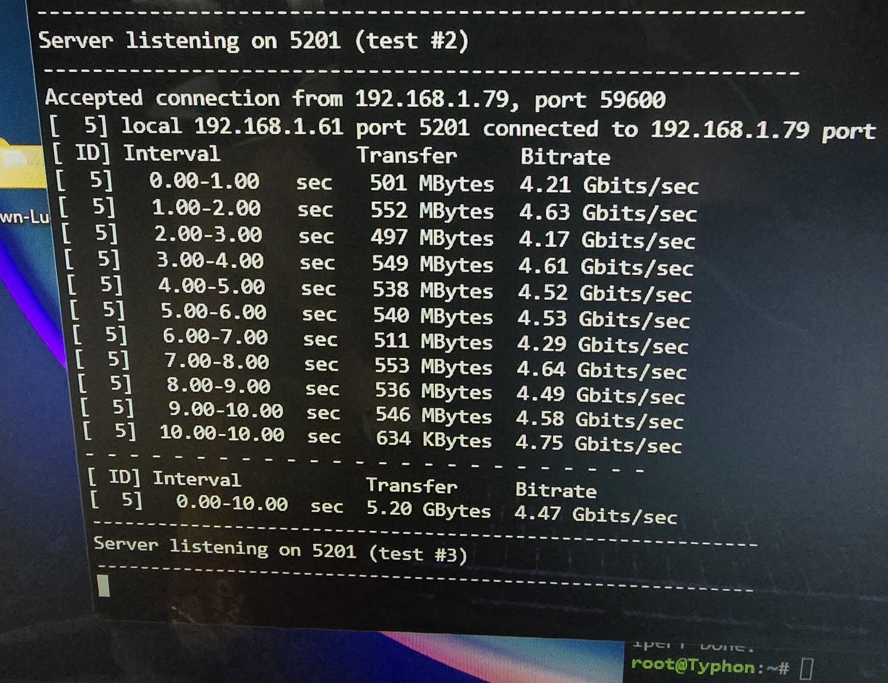

Is this normal for 10gbe speed transfer for 2 unraid server both have 10gbe nic connected to udmse using dac sfp+?
It show interface is 10000 Mbps but transfer rate on iperf3 is half.

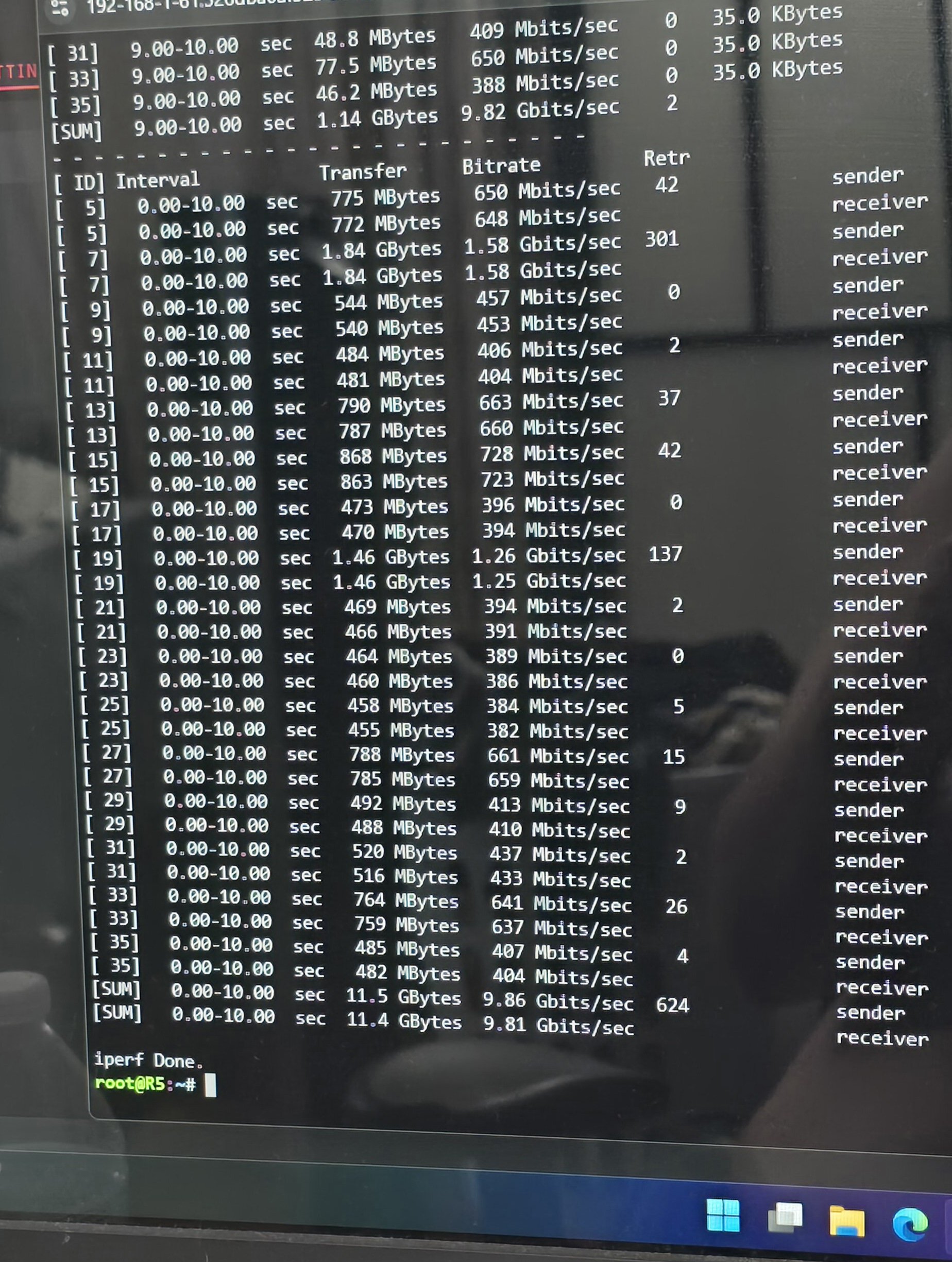

I tried iperf3 parallel connections see results on the photo. I also disable flow control on the UDMSe  but enable it on both unraid. ( disabling it on unraid side doesnt get any improvement). MTU both on 9014. Tried different TxRx buffer size not much different. Tried Nic offload on and off not much different.
If i run iperf3 single it only giving me 5Gbps.
Edited by hellbhoy
Wrong photo upload
