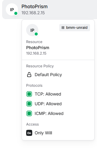

in twingate you can make 2 admin users and setup remote lan or sinagle IP to access xyz target from each other.
as example you can setup single user on premison policy for the vpn to only allow user (Machine...) and access to 1 IP on your lan:
this way when they are on the "vpn tunnel" they can only talk to this machine...

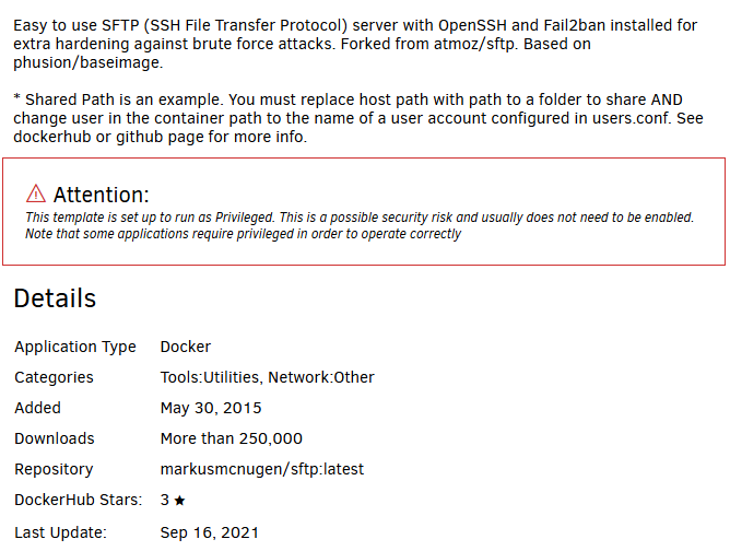

I would also recomend the docker sftp. and not use unraids ftp / ssh in favor of that.
You can then add paths and users to a secure ftp server with fail to ban prebuilt...
run default sftp setting appdata pathing first. after first run it wills top with error no accounts...
then open the sshd folder:
Make user conf (this makes the useers who can login...)

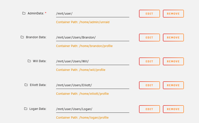

Then edit docker and add paths for folder you want shared... and put it in container path /home/%username%/%random_folder_name%
as you can see I structured my data into a user folder...

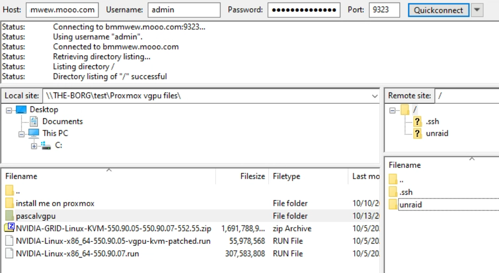

I have a sftp user password for me, will, logan elliot. and can use ftp, if they ftp they only have access to that one folder... nothing more... --Yest you can grant more than one folder....
with sftp anything in the home user folder as a folder name will be in ftp:
I often use file zilla as a go between form auto back scripts between my friends in a ring network. but it starts with being able to see them as if it was another machine in your home...
