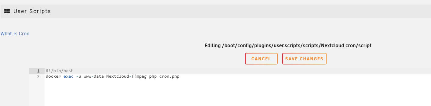

I’m having trouble with the cron job execution on an Unraid server for Nextcloud.

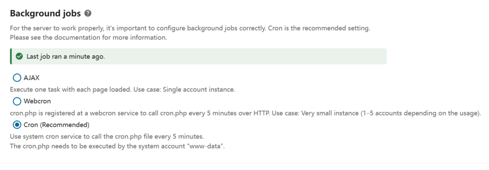

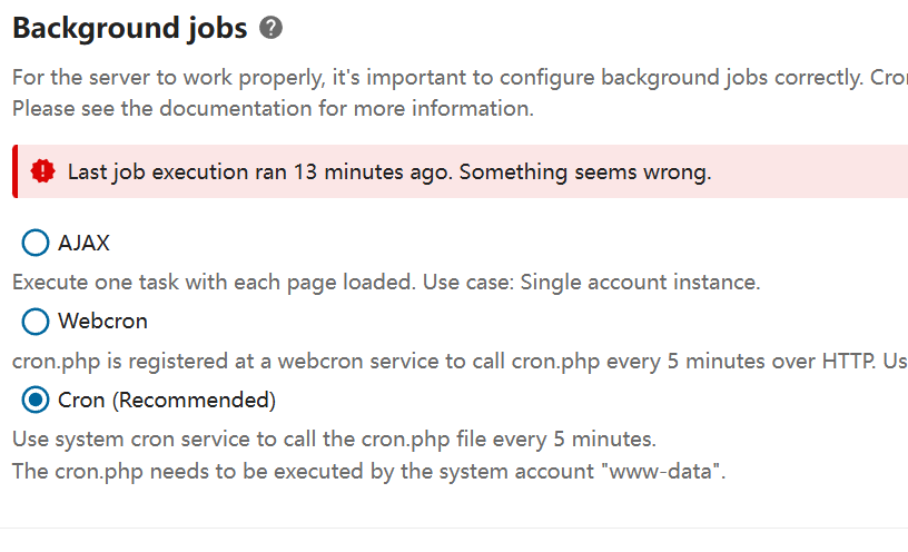

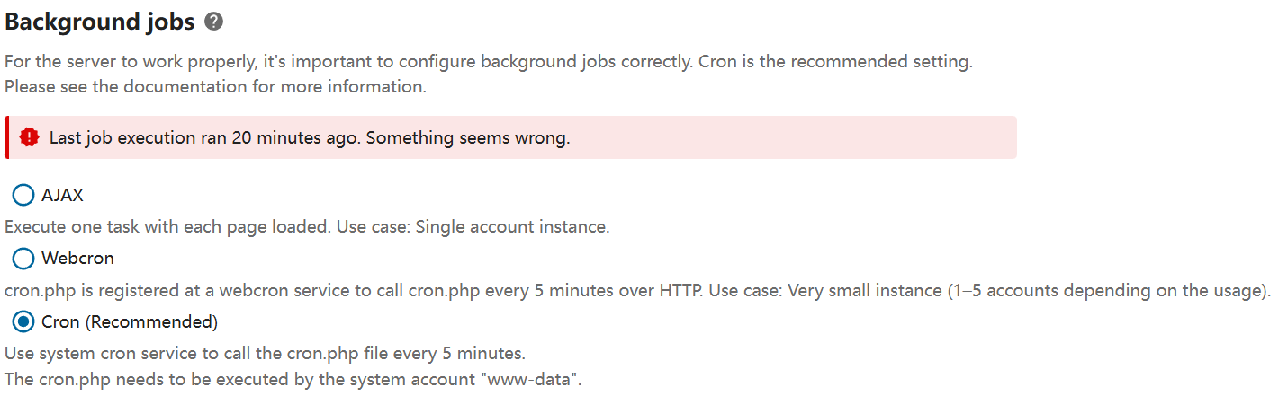

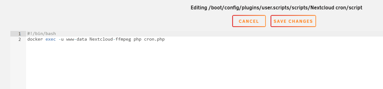

I used the "User Script" plugin, and put in the follow cron jobimage.thumb.png.b352d3d4fb0de962ec91c4ee09a7fb70.png:
somehow there was one successful run of the cron job, yet I am not sure through which method.
image.thumb.png.318c938b6e896a4cdd2fe27a1a74ddb8.pngimage.thumb.png.08e83d7e9b45da3fdebfa892df60307b.png
If I click on the "run script" button on the cron job tab, it doesn't give any response and doesn't exit/finish either.
I also tried to type out the comman in consle, and no response:
##### Update:
I waited a while before check back on the server, it seems like it had another successful run, yet the status of the other jobs stayed unchanged.

@not-a-teletubby this is how my cron job is set up:
And it seems like its working with cron. Not too sure how it worked out, but this is my set up

In case it's useful for anyone else:

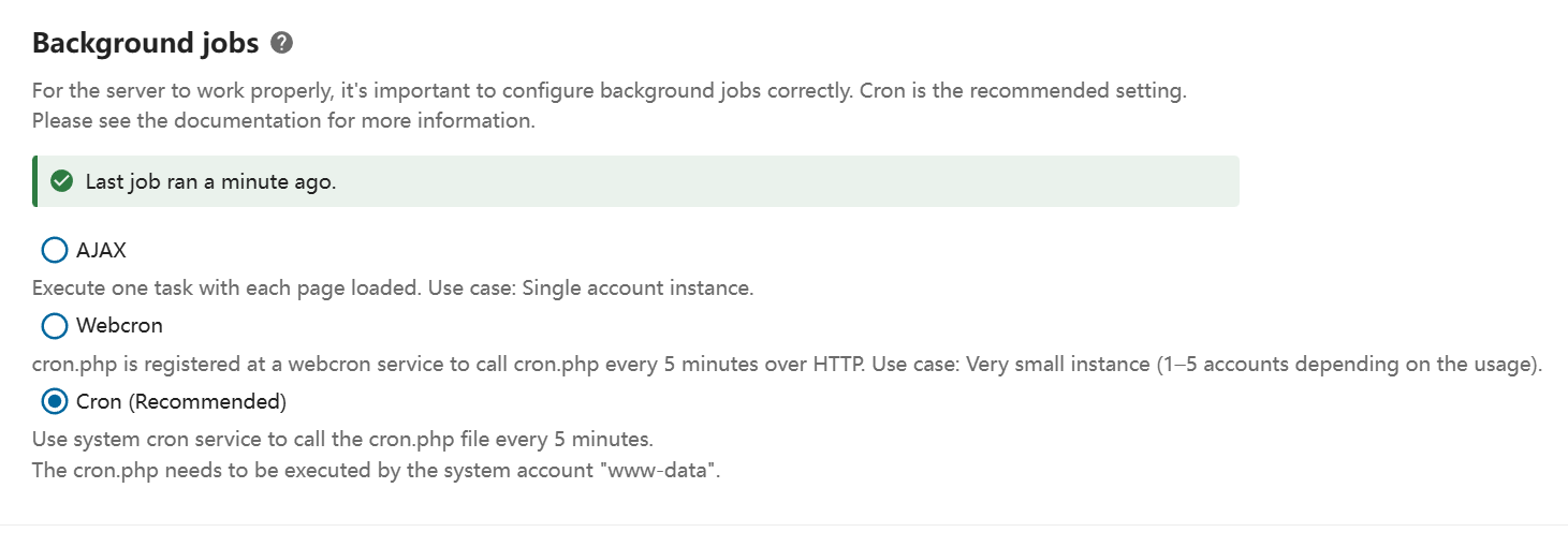

  • Switching from AJAX to Cron solved the admin Web interface just locking up completely for however many minutes (never saw this resolve otherwise).
  • The user script line that's worked for me so far is `docker exec -u 99:users Nextcloud php -f ./cron.php`
  • Task is currently running, but occasionally stating "Fontconfig error: No writable cache directories".  Will update again later when I know more.
Edit: ran with `--verbose`.  Bunch of UpdateSingleMetadata and a ScanFiles job ran.  11-12 seconds each for the 13 runs of UpdateSingleMetadata.  Then ~46 minutes of ScanFiles.  No further "Fontconfig" error messages.

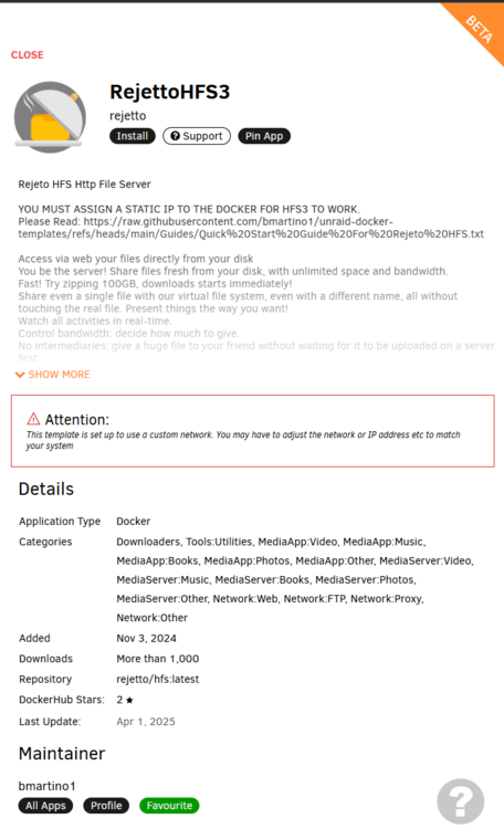

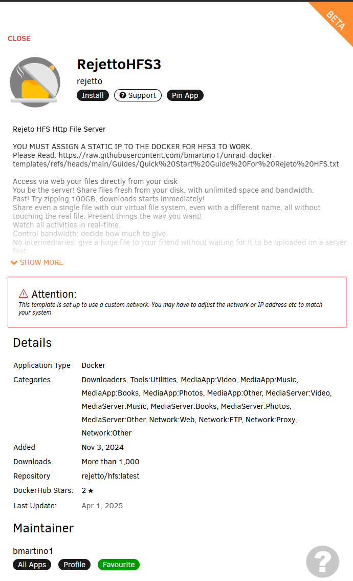

I helped rejetto port a template over for unraid:
https://raw.githubusercontent.com/bmartino1/unraid-docker-templates/refs/heads/main/Guides/Quick Start Guide For Rejeto HFS.txt
I may have to make some small updates and bring it out of beta small notes if using rejeto hfs on unraid...
