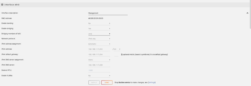

Under Unraid networking settings, I've configured ETH0 interface to DHCP and assigned it as a member of bridging interface Br0.

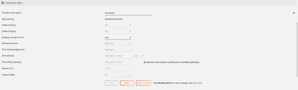

Furthermore, I've configured ETH1 interface to DHCP and assigned it as a member of bridging interface Br1.
So far so good. They both receive IPs ending in .253 and .252 respectively.

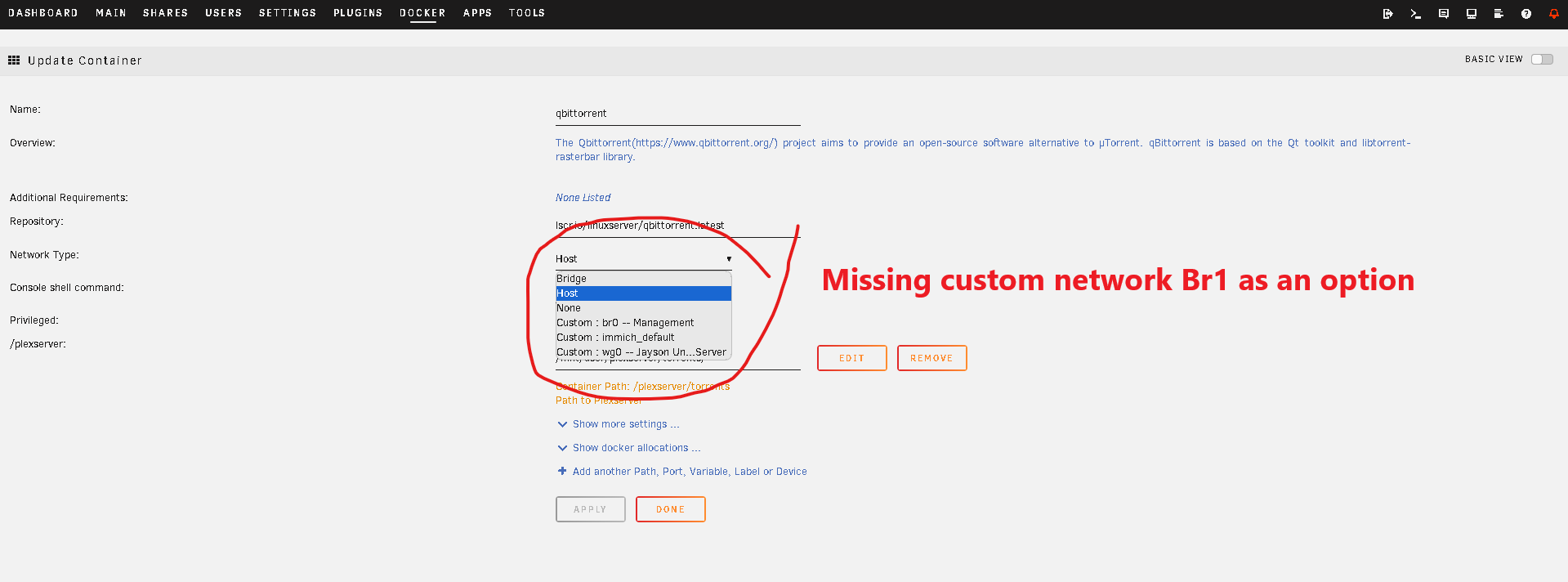

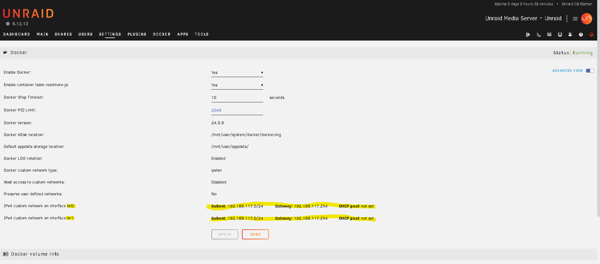

My issue is that when I go to create a docker app and select the network to attach to the container, my only option is bridging interface Br0. Must be missing something obvious here I feel. Anyone know a trick to get the Br1 interface to show as an option?

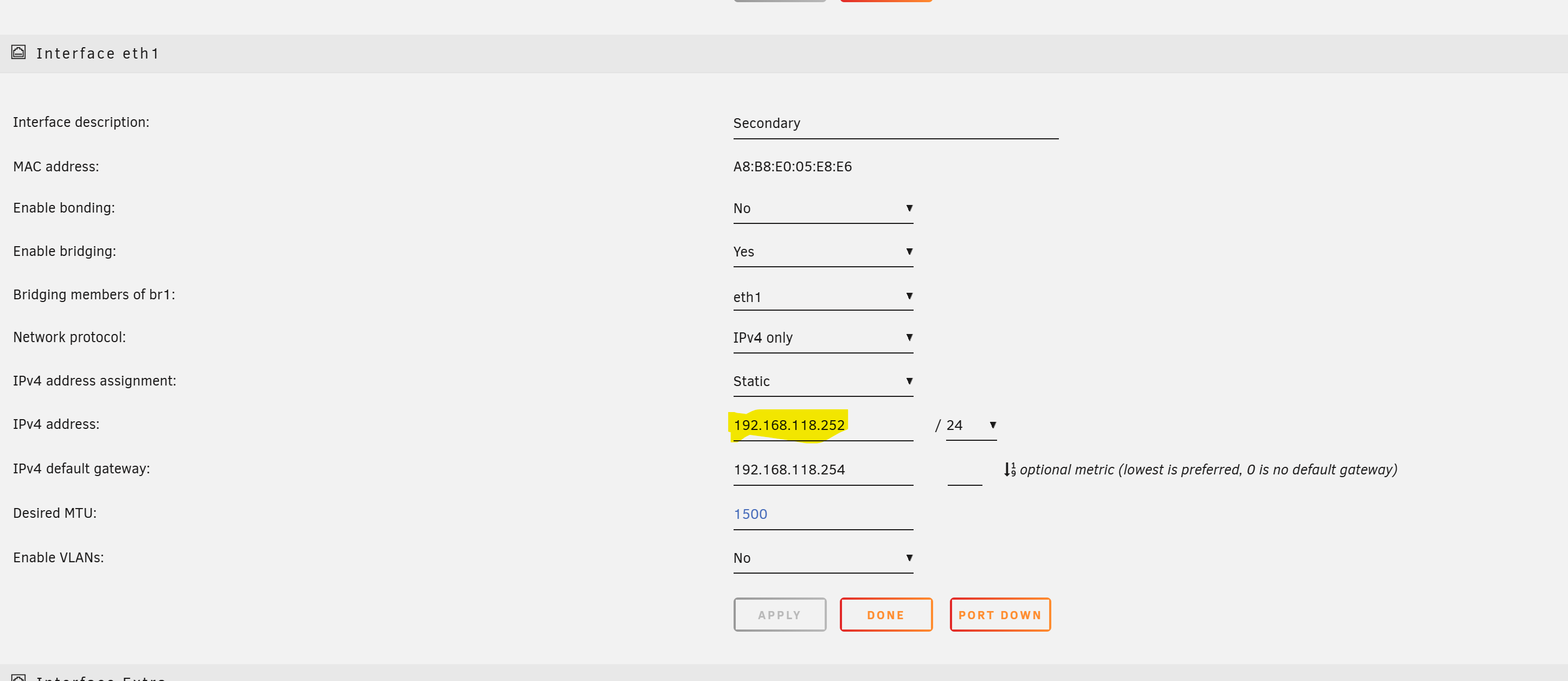

On 11/16/2024 at 7:09 AM, famousjaxx said:
both get separate IP addresses from my DHCP server on the same LAN subnet, which is 192.168.117.X
That's usually not a valid configuration, different NICs should use different subnets, does it show up as an option if you set a static IP in a different subnet?

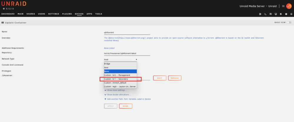

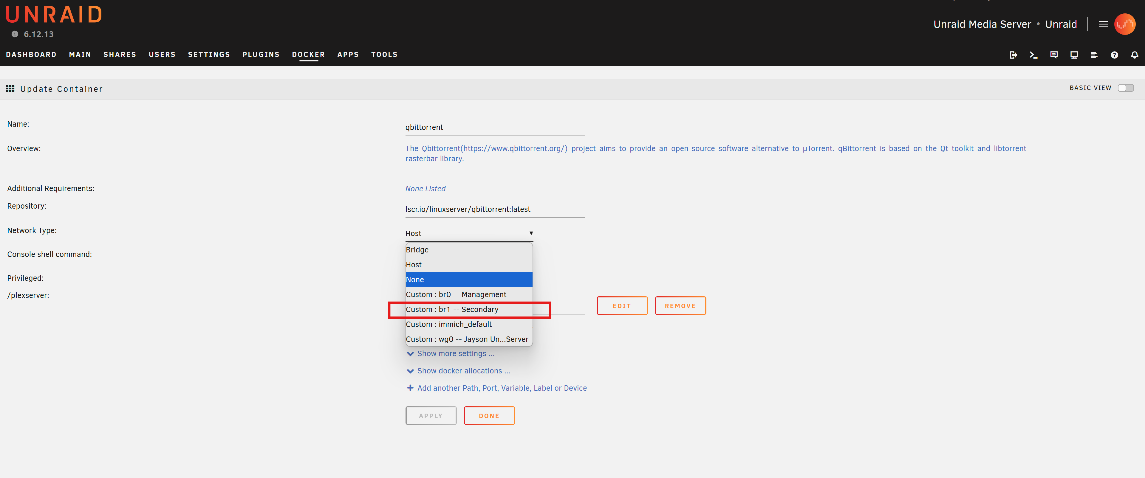

Thanks for the reply - yeah that appears to fix it immediately.
I get that we might frown on such a configuration but there's no reason this shouldn't work if you know what you're doing and set the proper gateways and route metrics etc.
I guess the alternate solution is to put both NICs on separate VLANs to achieve the same solution.
