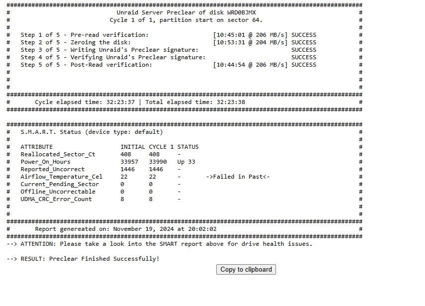

I'm now running a 2 cycle preclear using pre and post reads but has anyone seen this before when a drive seems to bounce back into good health?
Assuming the pre clear cycles pass without error I'm unsure if I should trust the drive again.
What are your thoughts?

It's normal for pending sectors to disappear after a full disk write, the question is if they will come back again soon, run a couple of SMART extended tests, and if they pass you can try giving it a 2nd chance.
So after another preclear with no concerning values I'm considering adding the disk back into my next vdev expansion
Just to update this thread, the drive continued to flag issues and was replaced out of caution.
